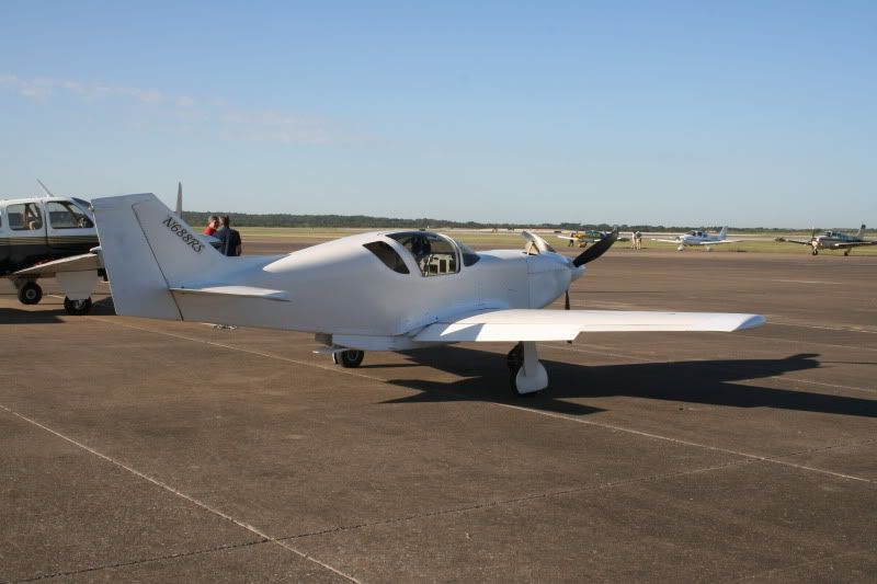

Yes that is it. Here is a photo I took of his airplane on the ramp before the race last weekend. You can see the door open at the rear of the belly scoop. I have been a little slow on appreciating this fellow's work but in the couple of races he has flown he is blowing the Sprint class. He may be a class rule changer in the making. The front of the plane flows out from the spinner with no common air intakes there. It is a plain work in process looking plane so the tendency is to just casually scan it - no more, next time I will photograph the heck out of it.
