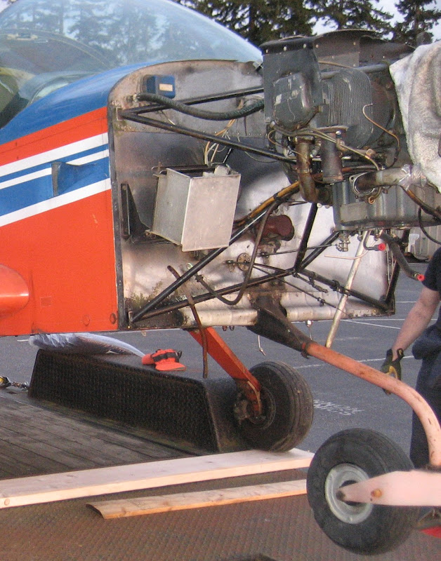

RV-9A:
Jabiru:

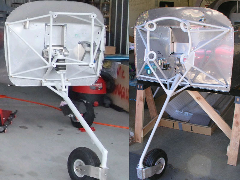

As requested,
RV-7A vs RV-10:

The Jabiru looks nice - ridged, light weight and not likely to stick a non-moving piece into the ground. But it would put the the wheel in an entirely different location. Then the RV-10 looks pretty good too. Am I correct in assuming it's made of tubing? Presumably the design is intended not to flex and would hopefully completely fold up on failure rather than snapping back and causing the airplane to pivot on it. From what I can see of it a new builder (me) would do well to utilize a design similar to the 10.

The -10 design looks so similar to the -7A design that it might be pretty easy to change. The pivot on the -10 sits below the lowest bolts though, and on the -7 there isn't any extra room there. So there are still challenges, but it doesn't look insurmountable.
