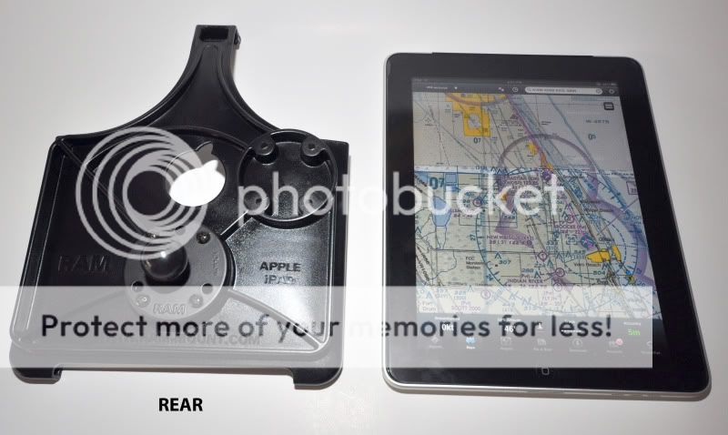

I finally got the iPad holder today that I've had on order since May. RAM Mounts kept pushing back the availability date, supposedly because of mold problems in its development.
Anyway, I'm posting a mini review in the event anyone might be interested in going this route for their iPad. I had been using the knee-board holder that I suspect a lot of folks have been using, an aluminum box with a hinged top containing a spring clamp. It works well but I thought there was a better solution for my particular setup.

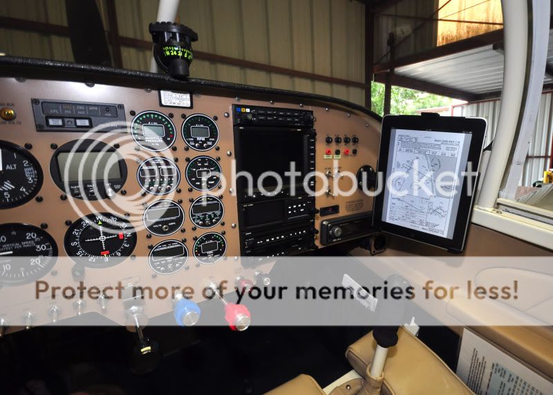

So I went out to the hangar this afternoon to try it out in the hangar and take a few pictures. Here are a couple of the holder:
And this is what it looks like from the baggage compartment with a wide-angle lens:
I'll post a couple of more pictures in the next post.

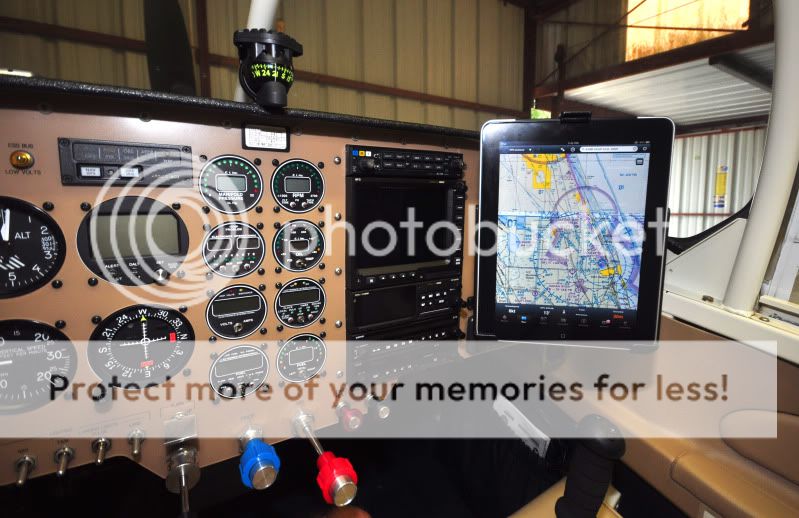

So far, I'm quite satisfied with this setup. The quality of the holder is typical of RAM mounts--very good. It's plenty sturdy and looks like it will hold up well. The iPad is inserted into the bottom of the holder and then the top finger that has a small roller is pulled over the top and latches into position. I'll list the parts I used in case anyone is interested:
2 ea. Bases: p/n RAM-B-202U
1 ea. Arm: p/n RAM-B-201U-C (about 5.2" long)
1 ea. Holder: p/n RAM-HOL-AP8U
Here are a couple of panel pictures. The first picture shows the rear of the holder where it attaches to the panel:
And here a picture of the iPad stowed against the right side of the interior:

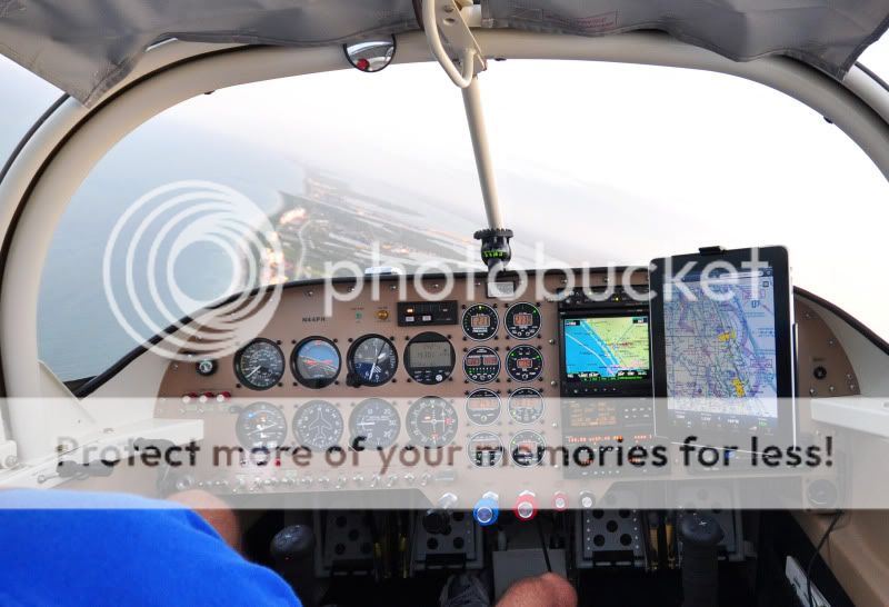

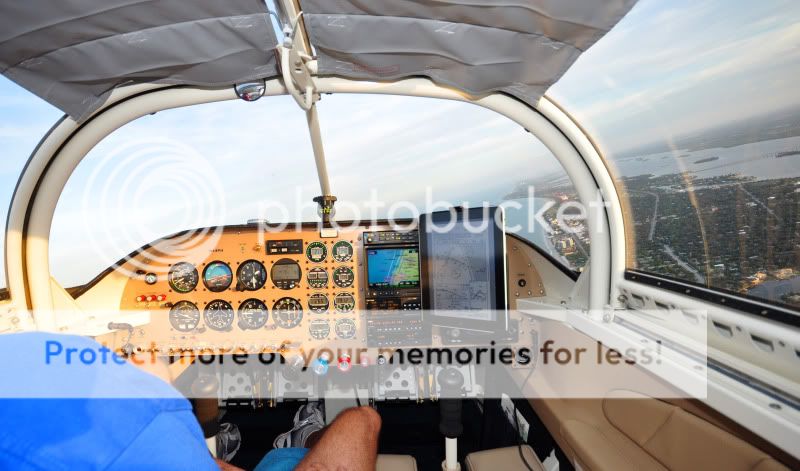

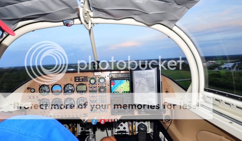

Went up flying today late in the day to try to get some glare on the iPad for some photos and also to try out the new iPad holder and mount. Here are some representative examples, some with glare and others as the sun was going down to simulate IMC conditions. Anyway, hope others will get some idea of the suitability of the iPad as an EFB.
Also here is a comparison of the iPad brightness next to the excellent screen on the MX-20 MFD.
Here is the worst of the glare I saw today:
Typical view in the shade from the Koger blind:
This was on final as the sun was setting behind me:
By the way, the RAM mount performed flawlessly. I am very happy with it! And the standard disclaimer: I have no connection with RAM or iPad, just a happy customer.
