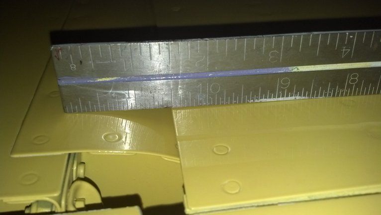

During my Phase 1 testing I had a heavy Left wing. I didn't notice anything at low speed, but did once speed got above 180mph. I was breaking in my engine so didn't spend much time at lower speeds. At 200mph, if I relaxed my hold on the stick, the plane took a hard roll left, the faster I went the faster it rolled. At WOT it was scary for a lowtimer like myself. As I released the stick, My ailerons would deflect (left went up, right went down). So after making many calls to RV'rs, I measured the aileron outboard hinge placement. Sure enough my left aileron hinge pushed the outboard leading edge above the wingskin. slotting and dropping the hinge and I was flying balanced at cruise and higher. I still don't know how it affects slow speed, but I don't notice any adverse effect.
pic of aileron to wingskin alignment
Then during more high speed testing I found a new problem. Unstable in roll axis. I would tap the stick sideways to check stability, but instead of damping out, it would rock back and forth getting worse with each oscillation. After 4 or 5 rocks, I had to tighten my grip to keep things in check. A check of the trailing edges of the ailerons revealed a bloated radius edge instead of a flatter profile. I fixed this using 2 paint sticks with tape for scuff resistance and my seaming pliers. A very subtle squeeze on both ailerons took care of the unstable roll.
hope this helps

This worked for curing our hard left roll when at high speeds, but we still have a right roll at low speeds (landing and takeoff speeds)
