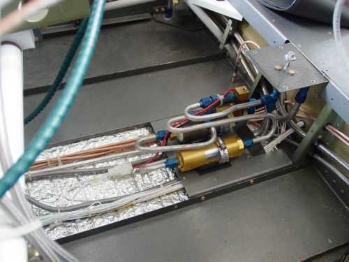

i went with gasolators in each wing root... using them as filters that are easy to access and provide protection of the boost pump. fitting them was not terribly problematic but does involve making a mount and dealing with the tubing in a restricted space. ultimately i had to use a couple of speciality hoses and fittings from bonaco on the left side. the wing root fairing also needs to accommodate access for the fuel drain.
here are a couple of shots during the final piping installation...
left wing with a regular fuel pickup.
right wing with a flop tube.

That is really an elegant solution. I have a fuel filter in the bottom of my fuselage, just before the booster pump. I have been scratching my head about how to clean that without getting fuel all over the interior. This is a much better solution to the problem.
Do you think there will be any problem with resistance to fuel flow?

Stephen, What is your plan to shut off the fuel to service the units?
