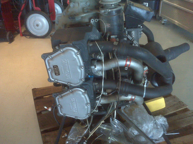

Are the cowlings a little different for IO 360 angle valve vs the parallel valve for the 7? The reason I ask is that last night I was reading an older article (15years) in the 20Years of RV mag and it was talking about how a guy had to make a bunch on cowling mods to fit his IO 360 A1B6 angle valve. He was building a 6a.
I am close to getting my hands on a this engine for my 7. And was wondering since I already have cowling that came in the finishing kit.

Actually I found out tonight the engine is actually a IO 360 A1A, 200hp, (pic'd above) horizontal induction. I already have the cowl with no scoop, so we're good there. From my research I don't believe there are any issues with this engine and my cowling set up.
Tear down is under way...

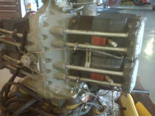

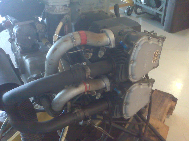

more pics.
