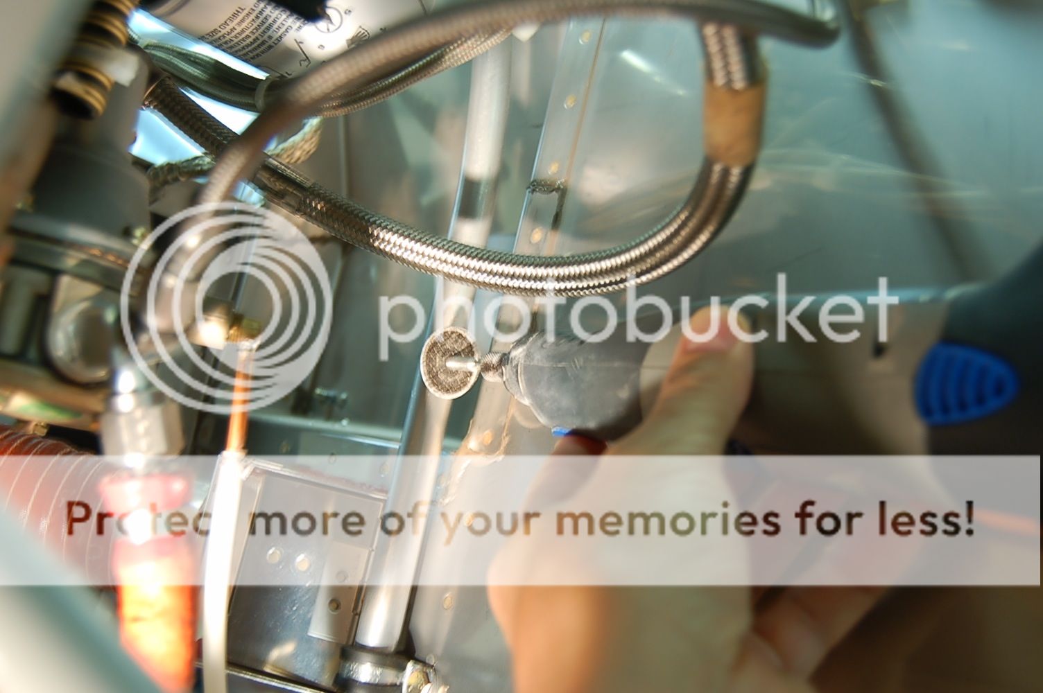

We are about to cut a square out of the RV-3 firewall to rivet in the standard Van's recess (for the prop governor), and I was wondering how folks like to cut the thin, soft stainless. I have used punches for round holes, but this is going to require some long straight (8 - 10 inches) cuts, and I know that if we heat it up, it'll be next to impossible. Already installed on the fuselage, of course, but very accessible.
Tools? Techniques?

Paul the Dremel thing might work good. Fits perfect and cuts clean. To prevent overheating and burning just go slower or heat sink with a bucking bar.

Paul, The cut off wheel that Van's sends out to cut the canopy will work just fine for cutting the stainless. Drill the corners so you will have a clean start and finish. Use a guide, and the speed of your drill motor is plenty for this thin material. Cut it just like you did with the plexi.
Don't worry about heating it up........ (you won't with your drill motor).. the cut off wheel could care less in something this thin.

I work in the marine industry, as such, I fab and weld tons (literally) of stainless every year. I would drill each corner so you have a start/stop point and round corner, then cut it with a straight die grinder with a 3" cutoff wheel. I would use as thin as one as I could get, I buy ones .035" for work. Keep the RPM and travel speed up and you should be able to cut a pretty clean edge that would just need some touch of with a 2" or 3" sanding disc on a right angle die grinder.

I was actually hoping that "cutoff wheel" would be a popular answer, as that is my favorite tool for cutting squares and straight edges (after drilling the corners), so that's what I'll use. Just didn't' want to start with it on stainless and discover that all I was doing was making the stainless mad....
