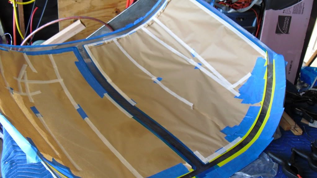

-Masking tape: I played with several different masking tapes. I tried yellow electrical tape, 3M blue paper masking tape, and some very old Permacel P366 plastic tape. All tapes mask pretty well but line created by the paper tape was just a bit less crisp than the vinyl tapes. However, I found the electrical tape much harder to work with due to the fact that it stretches. I leaned toward the Permacel tape, which by the way, appears to be obsolete. Mine has a 2001 date on the roll!

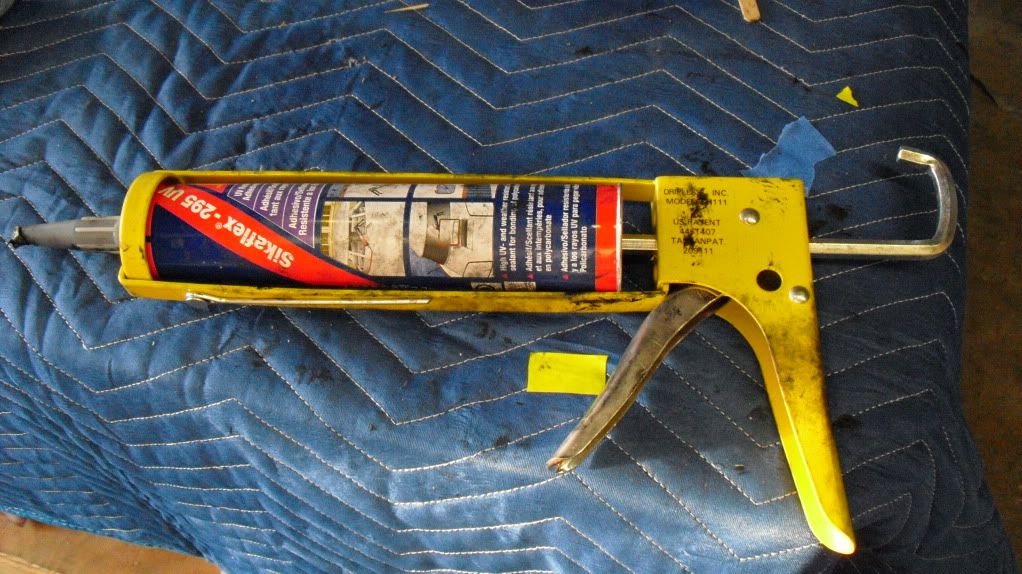

-I bought myself a $9 caulking gun. I've only used El Cheapo caulking guns in the past. Do yourself a favor, spend some money on the gun. I got a dripless one made by a company with the imaginative name of Dripless, Inc. Boy, they sure worked hard on THAT name eh? Anyway, I really like their gun because when you stop pulling the trigger, the caulk stops. No more being a quick draw with your thumb on the lever. It made this easier and easy is what you want.

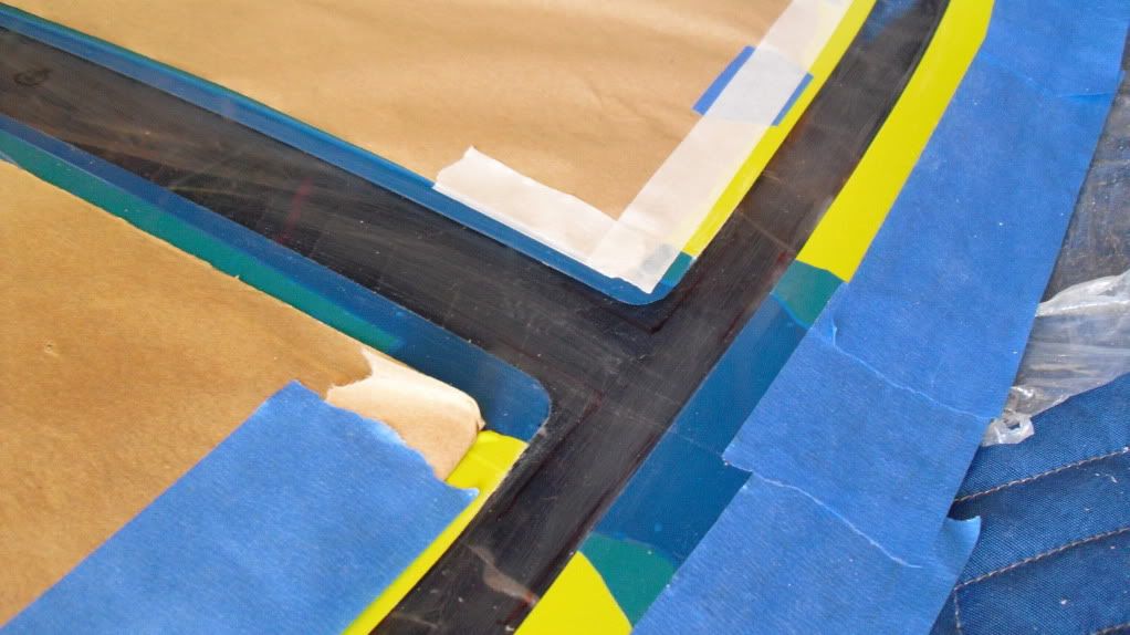

-Lay down the primer in one pass. OK, I said it. It was said to me. Making that happen, really tough! I have one run that looks beautiful, the rest, not so much. When you go over it again, you get brush strokes that no way no how you can get out. Like I said, I was warned and I tried but no dice. I'm not making a show plane so it is what it is.

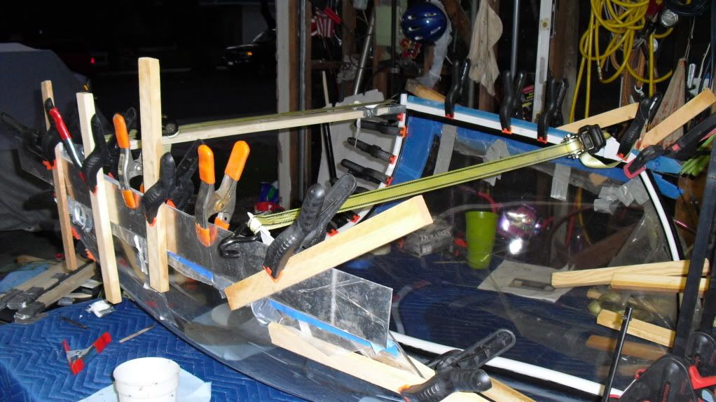

-I cut the sides of the Plexi about between 1/16" and 1/8" up from the side bows. I primered the top of the side bows and the sides of the Plexi. Then, I put a piece of aluminum outside of it all temporarily and ran a bead right there between the top of the side bow and the Plexi. Later, I will glue the side skirt to the Plexiglass.
-I found that it was difficult to get the frame right back in the same place as it was previously after removing it. So go conservative on the trimming of the sides of the Plexi. You can always sand some more down just before you bond as I did.

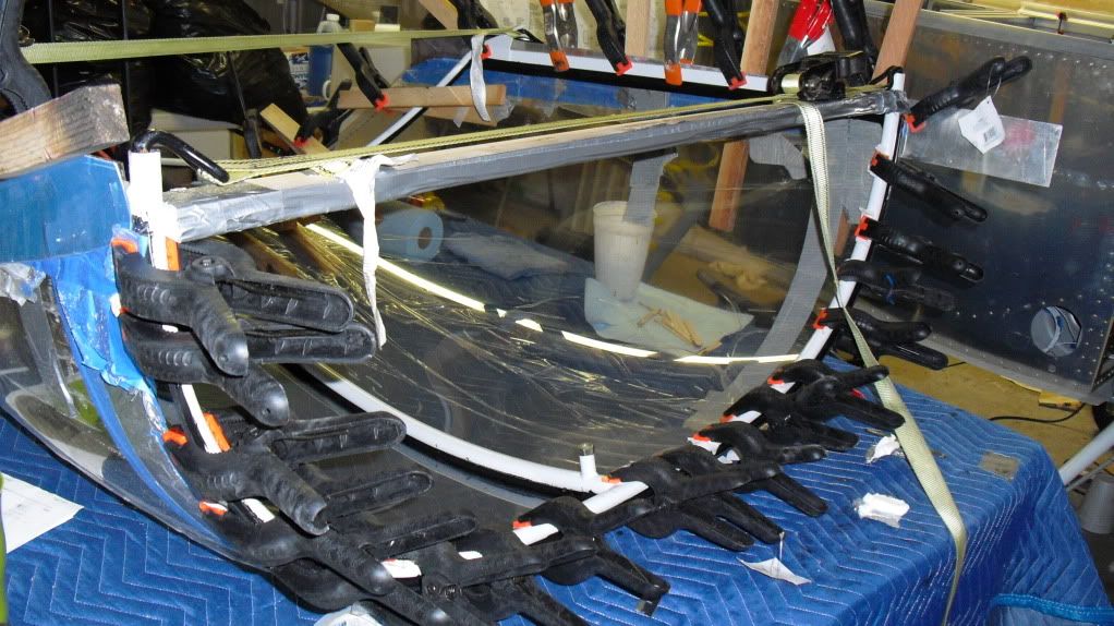

-I measured the Plexi spread of the frame while it was all clamped up. Using a strap, I pulled in double the amount of the spread and I am holding it throughout the cure. This has worked for others. My Plexi pulled the front and the rear of the frame by different amounts. Check them both.

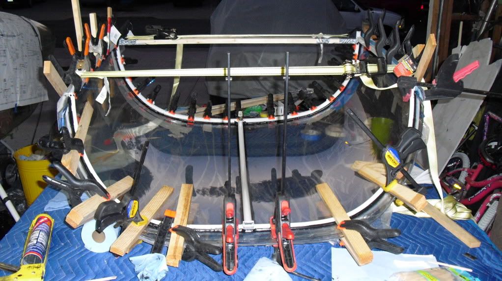

-You can never have enough clamps. I went to the flea market and bought every clamp a vendor had for less than a buck a pop. Metal spring clamps were recommended but I couldn't find enough so I went with the plastic spring clamps. I found that the plastic ones had stronger springs than the metal ones that I found.
-I initially clamped the frame by extending the clamp tips past the bar I was clamping and to the Plexi on the other side. Can you picture that? I did this because the clamps didn't like to stay clamped onto the metal tubes. They would every now and then jump off with a loud bang! I thought for sure they would crack the Plexi but they didn't. However, they clamp much better when the tips of the clamp are on the frame tube. I found somewhat of a fix by taping the ends with the cheap, white masking tape. My white tape has more traction than the blue tape and the clamps don't slip off so easy anymore.

Adding to the clamp advice, as I believe RVtach wrote, buy as many clamps as you think you'll need, then double that amount, then get 50% more and you'll have almost enough. Seriously. I should've bought stock in the company that makes Pony spring clamps.

-I struggled a bit with deciding how wide to make the primer lines. I initially thought 2" was good for the center overhead tube but that looked too wide. I came in a bit and ended up with something like 1 1/2" wide there. The rest, I just eyeballed. I wanted the primer to extend slightly beyond the tubes.
-I also tried to figure out when was the best time to pull the masking tape. I think I pulled it a bit too quickly...like less than 10 minutes. I pulled my test pieces after 30 minutes and they turned out fine. Lay down a few test pieces for yourself then decide.

I should have suggested laying down two layers of tape, one for the primer paint and a second layer for the Sika. You will now need to lay another mask for the final Sika filet to make it pretty.
