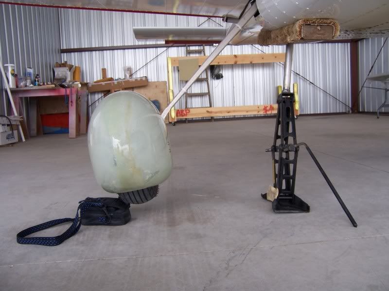

This works very well. Auto scissor jack rated at 2000# I believe.
John Bender

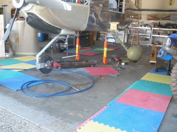

I used a couple of jacks from Harbor Fright, cost $50 @, and some scrap 3/8" plate stock.
Plane sits on a couple of 2X6 pieces about a foot long, have a hole about a 1/4" deep to socket the jack ram into so it will not slip.
I tie down the tail with a ratchet strap to an anchor in the floor.
HF has the same jacks for $39 right now, IIRC.

I built a nice saw horse type padded support for the tail with sides so no way could it move or slip.
I used a motorcycle jack with a nice 4x4 box I built under the wing spar. Works great very solid, no OH NO moments.
