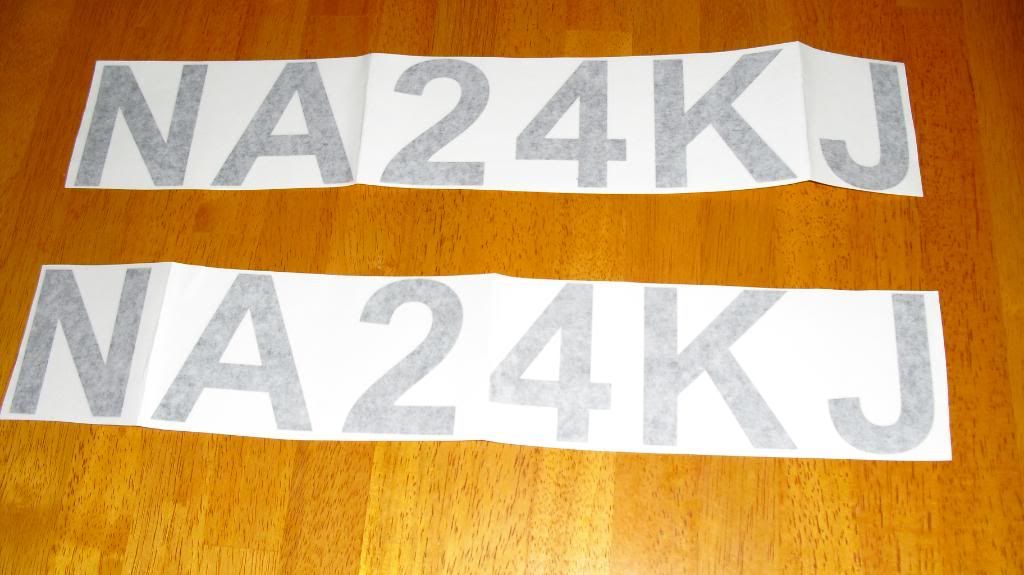

I found a very reasonable place that sells vinyl lettering on line. I didn't want to spend much on my N number because someday I will replace the decals when I paint. Also, I wanted individual letters for the "Experimental" decal inside the plane instead of a bumper sticker type of deal.
I got both my N numbers and the "Experimental" decals for $11.41 total with free shipping. 3" N numbers were $3.12 for each side and the 2" experimental was $4.20 plus tax since I'm in California and so are they.
They messed up my N number but they are sending me replacements. Good thing though because this allows me to practice.
I specified the FAA requirements for the N number and they nailed it.

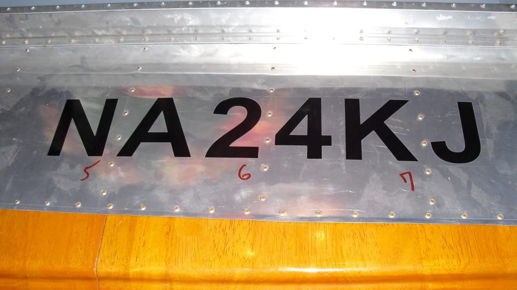

Here I praticed with the one of the screwed up numbers and attached it to the inside of a scrap aileron of mine. (Long story, don't ask)
Finally, the experimental treatment. Fake flowers compliments of my wife:
The place is called AlwaysSign.com. Shipment was lightning quick!

Looks like they "heard" A instead of 8!

Exactly, but I sent in the order via the Internet. They probably yell the orders across the shop to the letter cutter operators!

Those prices are cheap... maybe too cheap. I can only say that my materials cost more than what they charged. Cheap vinyl will shrink and crack, particularly if left in the sun.
So, those letters might be A-OK for short term use, but I'd specify Avery A-9 or Oracal 951 vinyl if you want your vinyl letters to last forever.
Cheap price will be very small consolation if you're trying to remove a cracked, sticky mess in a year or two.
