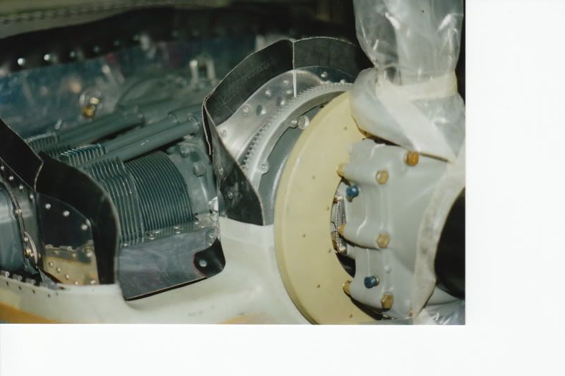

Old 06-30-2010, 05:45 AM
Posts: 5,685
Default The idea is to seal the plenum at the front end
This is a photo of mine taken during the build on 9-3-99. Notice that the rubber on the front of the baffle goes all the way to the front of the cowl, wraps under the outer edges of the inlet and is riveted to the baffle inlet ramp. The overlapping rubber seal strip attached to the bottom of the cooling air inlet of the lower cowl and extending over the baffle inlet ramp was not installed yet when the photo was taken. Six years of flying and no performance or service problems.
