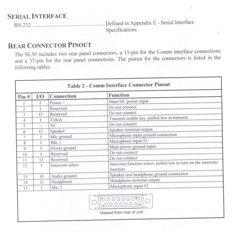

I have an SL-30 and am hooking it up to a skyview display, any body know the pin out?

Posts: 5,685
Default Here you go for the SL-30
