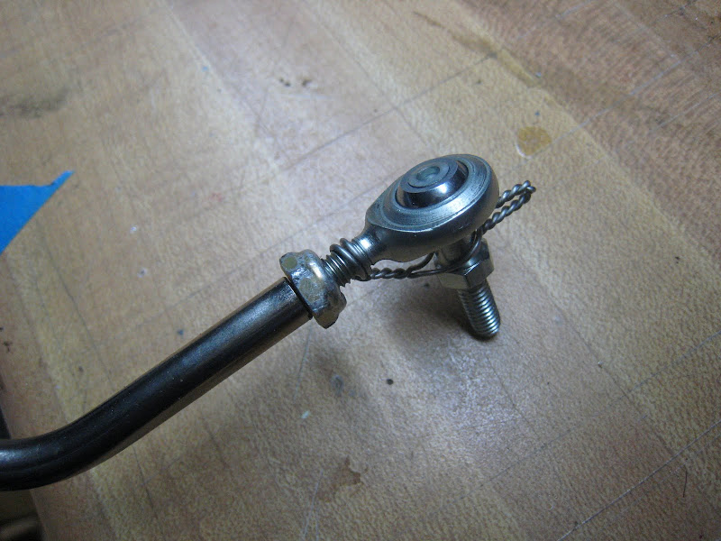

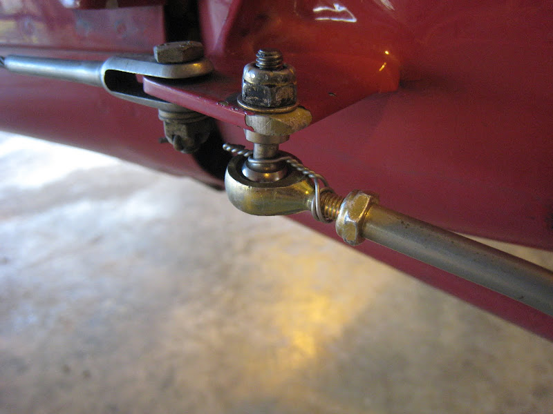

Default Safety Wiring the Rod Ends
OK, here's a picture I snapped in the hangar tonight - worth a thousand words, as they say....(and yes, I know the paint is chipped on the rudder horn - the Horror!!)

Hey Paul,
I'm not sure I understand how this safety wire will help in the case of a rod end failure. If the rod end failed, it doesn't look like the safety wire would keep the rod end from dropping off the bearing, leaving only the safety wire connecting the tailwheel link to the bolt. Any significant force then looks like it would simply snap the safety wire. Why not assemble this the same way other rod ends on the aircraft are assembled with a normal rod end, through bolt, and large area washer:

Hi Jason,
Good question!
This is not the "standard" rod end like we use all over the Van's kit - it is the "stud" version. You don't put a bolt through it - it isn't hollow. Looking at my picture, the "bottom" part (that you can't see) is just a flat end of the spherical part of the bearing - so if it pulled out in that direction, it would come off. So you can't put a large washer on there. The safety wire is, at best, a tenuous thread to keep the link from dropping, dragging, or bouncing around on the ground if the rod end fails.
