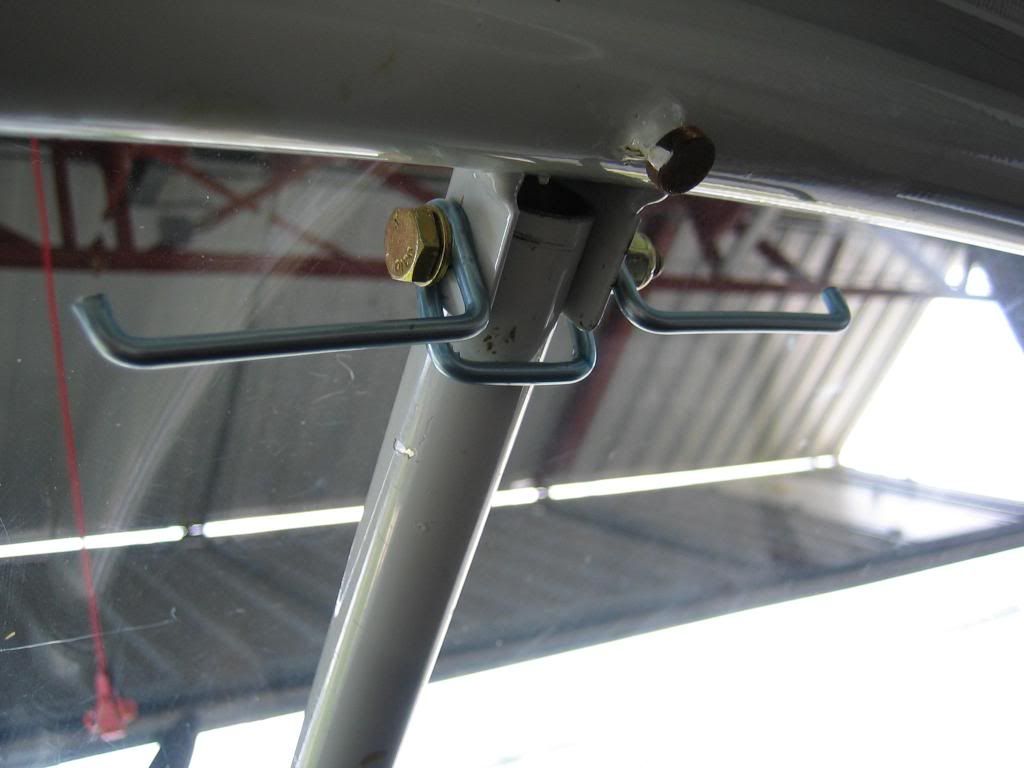

Doug Rohrer Doug Rohrer is offline
Join Date: May 2009
Location: Bowling Green, KY
Posts: 293
I made a double hanger out of .125 costed aluminim wire on a little bending jig and mounted it under the bolt joining the canopy roll bar. I also hang up my ignition key with a red streamer so I can see it from the front of the airplane wnen in the hanger.
I hope the pic loads (my first try)...
