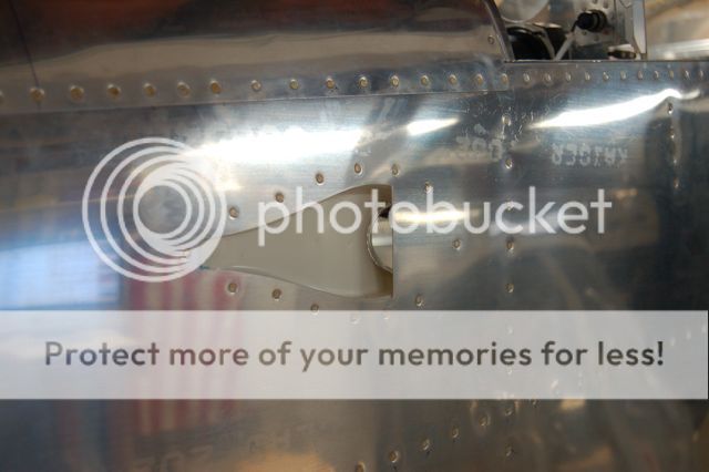

I saw examples of nicely done fresh air inlet screens. Is it necessary? If yes could you please post a picture or a suggestion how to make it in elegant way?
Screens I saw were inside here

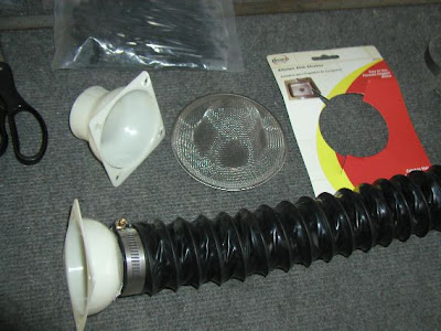

...from the aviation isle at the food store. Food strainer / colander is how the item was mislabeled, but I knew it for what it was.
One strainer provided enough material for both vents plus the fuel vents. I attached the screen material to the output port of the vent and slid the SCAT hose over that and hose clamped it all together. Works fine.

I cut mine out of a drain screen and clamped it between the black hose and the mount.
