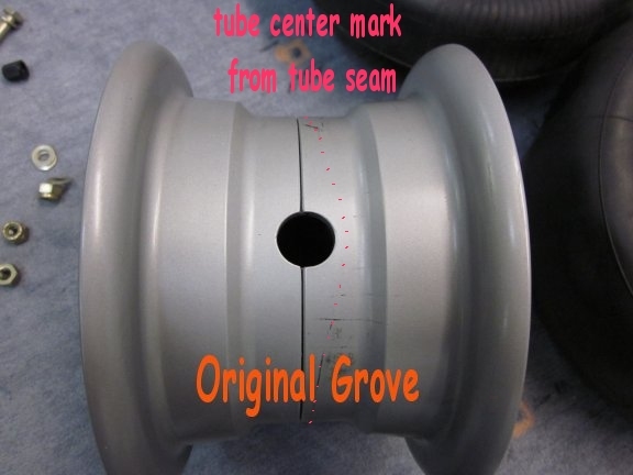

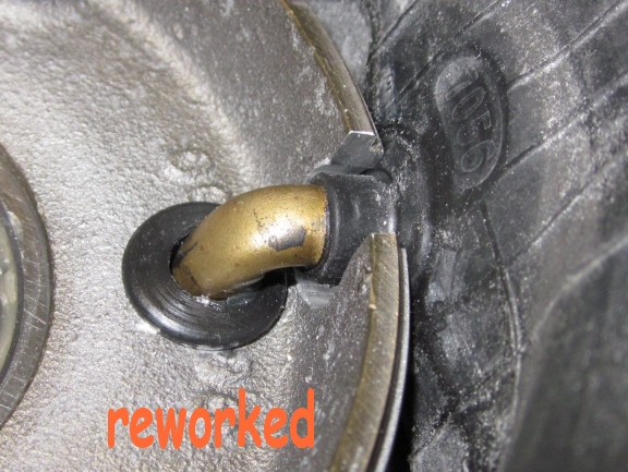

Default Wheel reworked
Hello Mike
After no response from Grove and other information from Steve at Desser about the tube, we deceidet to rework one wheel and collect more datas. Here are a few pictures of the reworked Grove wheel. We just rotated the halves and started on a fresh place.
Interesting to see the tube center seam mark on the wheel after it was mounted and under pressure for about 3 month.
I tryed on a tube inflated in a tire where the position should be exactly. It is only an estimate, but I think we got it really accurate.
I have the mesurements and will adjust it minimal, on an aditional wheel, when we feel confortable with the change. I hope my buddy will fly for the first time soon and we can build up hours.
There is not anymore a tear and squeeze on the valve stem.
We still have to cover the existing hole with a plug. Not sure jet how to do it, maybe molded rubber or a PTFE (teflon) plug.
I would recomend balancing after the wheel is ready to install.
I will do more picture when we rework the other wheels of my buddys and also mine, depending on the results we get. Also then I will place the mesurement about the new opening here.
Just our 2 cent! THIS IS STILL UNTESTED, BE CAREFULL WHAT YOU DO!
Regards Dominik

Old 05-25-2010, 01:02 PM
slyfox slyfox is offline
Location: idaho
Posts: 91
obviously you must have put the new hole 180degrees from the original. Now what did you do with the old hole, nothing, or seal it up.
Old 05-25-2010, 01:27 PM
swisseagle's Avatar
swisseagle swisseagle is offline
Join Date: Feb 2005
Location: 20km outside of Zurich, Switzerland
Posts: 467
Hello,
120°, the wheel has 3 screws, so it is not possible to do it 180° to the original position. Take a wheel apart and look at it inside.
We still have to cover the existing hole with a plug. Not sure yet how to do it, maybe molded rubber or a PTFE (teflon) plug.
Due to the fact that the opening is now only on one side, it it possible to have one big, round hole to plug, or two halfmoon holes, this would for sure "spread" the out of balance a bit. As recomended, balance before install.
Dominik
Old 05-25-2010, 01:42 PM
Location: idaho
Posts: 91
so you are saying you kept one hole and elongated it and than rotated the one half to the next set of holes and now have the other half hole in another position.
Old 05-25-2010, 07:35 PM
gasman gasman is offline
Join Date: Mar 2007
Location: Sonoma County
Posts: 3,821
The way I see it is Grove is using their standard 5X5 main wheel for a nose wheel. If you use a main tire and tube on this wheel, the tube would fit the proper way. That tube has the stem mounted in the center. The LAMB tube stem is off center by 20 degrees. Even when you move the stem hole to one side of the rim, the stem will be twisted up by 20 degrees to point out of the rim and be 90 degrees to the tire.
This is still better than mounting the tube with the stem in the center of the rim. At the price that GROVE CHARGES you would think that they would drill offset for the tube that we need to use with this size tire.
As far as balance........ It is not needed no matter how you fill that 1/2 hole.
