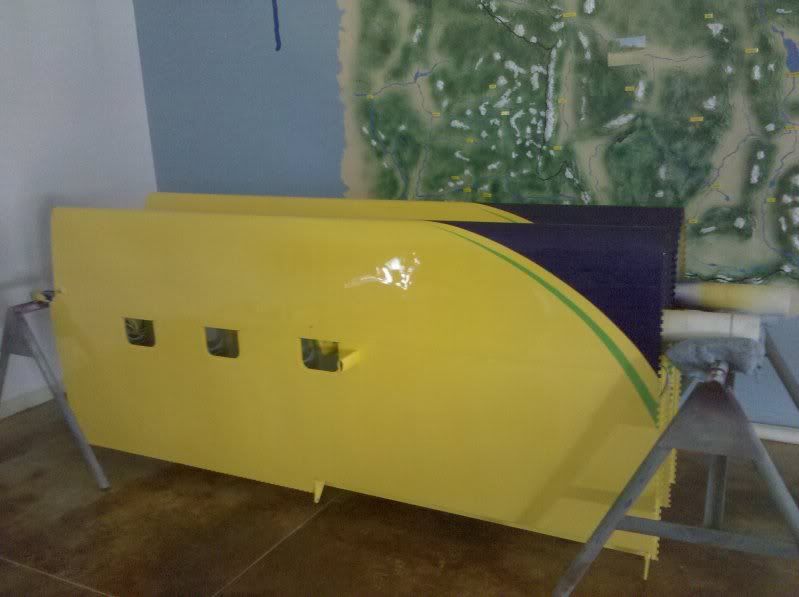

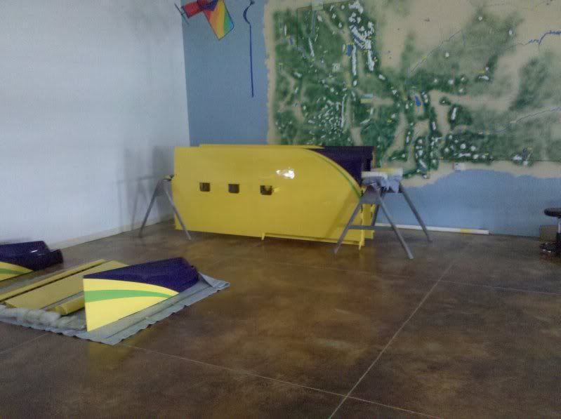

Finished painting my wings on 5/14. They stayed in the booth over the weekend, then on Monday 5/17. they were moved in a covered trailer to their new home. The painter who helped me said they could be put in service anytime, but warned against letting the surface rest against anything for any length of time for a month or so while the paint full cures.
here they are with the spar resting on 1 steel sawhorse and a piece of PVC stuck in the other end sitting on the other horse.

Originally Posted by hydroguy2 View Post
The wings look real nice, but I am curious... what is that on the wall?
It's an approx. 10'x20' topo map of Montana on my friends hangar wall. The white areas are mountains made of drywall mud. It was a winter project a few years back, the little yellow tags are different airstrips as they visit them.
