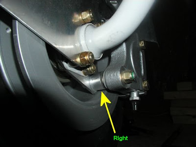

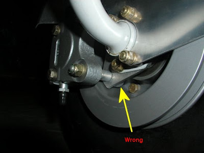

Can someone confirm as to if I have the brackets that the brakes will slide in on correctly or are they backwards..?

Thumbs up Good and Bad
