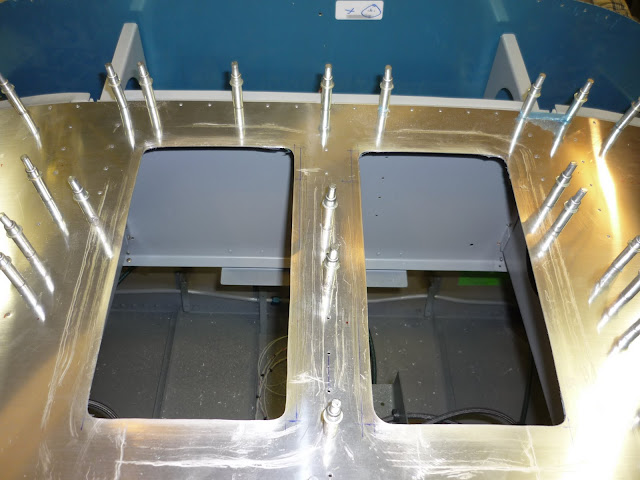

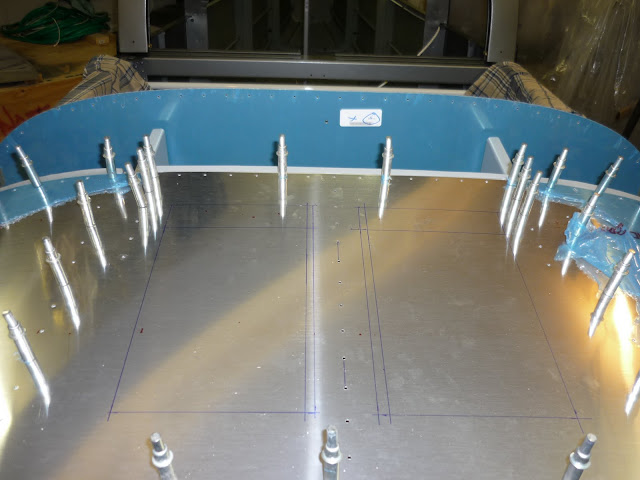

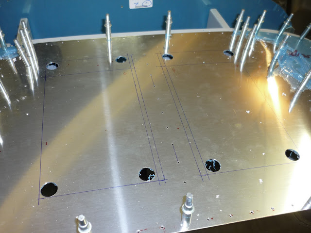

I am about to cut 2 access panel for my 7. I recall seeing a thread about this in the past but cannot find it. Does someone have or recall the link. I was hoping to get some ideas before I start cutting.

I was in the process of making two like yours, but then got the idea for one big one instead.
Check this link for pics and comments from Gus at Vans and at the very end, pics of my finished one.
http://www.vansairforce.com/communit...g+access+panel
Regards Alf Olav Frog / Norway
First RV-7 completed, (bought partly finished from a US-builder) 305 hrs per July 2014, SOLD
Second -7 had first flight Feb 25th 2014. 220 hrs pr July 2019. Life is good!

Mine are laid out (and installed) just like yours ...same size, same location. I'm happy with 'em.

ah yes..thanks that's the link was recalled seeing before. What are yall using to seal the access panels for leaks?

good enough for me. my panels are cut. time to order some skins and parts..
