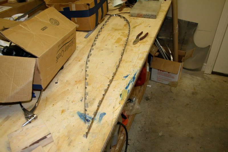

My semi-flat fiberglass wingtips with rounded edges were a bust and I wave been advised that sharp edges are necessary to get the desired speed increase. This is different than a tip plate in that the tip does not extend beyond the wing surface. The trick as I see it is achieving that sharp edge and not have any air gaps between the upper and lower wing surfaces and the flat metal tips.
I believe I have thought this through enough that I can do it. What I now plan is cutting a 1/2" wide strip off of the edge of the 6' sheets of 0.016" 2024T3 to be used for an inner flange. The sequence is critical to doing the job right I think.
1 - "C" clamp the spliced strip inside the wing skin, hard against the inside of the leading edge, outboard edge precisely aligned with the wing skin outboard edge.
2 - Start at the top front of the wing and carefully drill a #30 hole in the flange strip through the center of the forward wing tip mounting hole which is already sized and dimpled for a #8 flathead screw (that's what I mount my existing 8 wing tips with) and 1/8" clecoe it in place. Then move to the next hole aft and repeat until the last one is done then do the bottom in the same way. Mark for wing tip and orientation and remove the flange strip.
3 - Saw 120 1" brackets from 6061T6 sharp corner 1/16" thick 3/4"x3/4" angle (break sharp edges, etc., etc.) and "C" clamp them to the inside of the flange strip with the outboard bracket vertical surface precisely aligned with the flange outboard edge and drill a #30 hole in the horizontal surface using the flange hole as a drill guide. Mark every bracket and the flange with a corresponding number so every bracket has a specific installation location.
4 - Using a non-floating plate nut as a drill guide, clecoe the bracket, flange and platenut (oriented for&aft) together with a 1/8" clecoe the drill the first platenut mounting hole with a #40 drill. Clecoe the stack with a 3/32" clecoe and drill the other mounting hole. Repeat the process until all of the holes are drilled then disassemble for cleanup, deburring etc.
5 - Enlarge the screw holes in the flange and brackets to clear the wing skin dimples (1/4" to 3/8") dimple the platenut mounting holes in the thin flange and countersink the mating 3/32" platenut mounting holes in the brackets for the 3/32" rivets. Take apart debur the enlarged holes.
6 - Rivet the FLOATING platenuts to the stacked flange and brackets.
7 - Clecoe the flange assemblies back inside the wing.
8 - Cut oversize tips from the large sheets of 0.016" 2024T3 aluminum ...
9 - At this point the bracket present a fairly large target but I need to refine the process for drilling holes through the tips into the brackets and clecoeing as I go. There are several ways to do this but I have to work it out yet.
10 - Remove the tip and flange assembly from the wing, dimple and countersink and debur the tip to flange bracket mounting holes and rivet the tips to the flange assembly.
11 - Use RTV to seal the inside of the interface between the flange and the tip.
12 - Reinstall and progressively mark, cut, try and repeat until the flat internally sealed sharp edged tip exactly matches the surface of the wing skin.

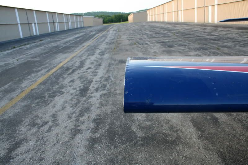

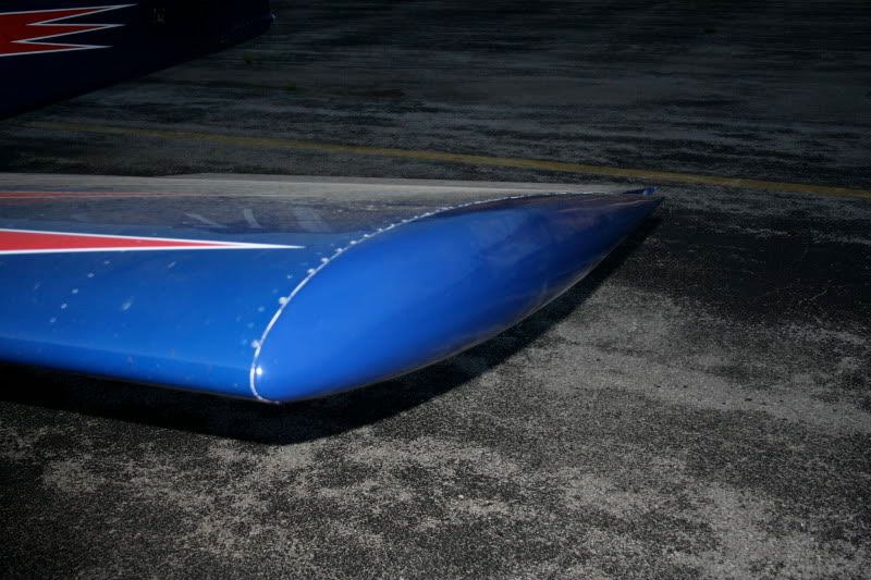

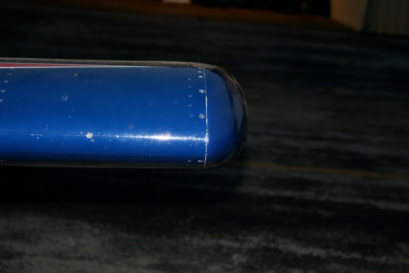

I got to spend a little time at the hangar yesterday working on a better solution for the fuel drain fairings. With the half hour left over I decided to remove the right wingtip and take a look at what I have to deal with to implement this "simple" conceptual design. The problems are several. The skin extension past the last rib is not consistent; the tip screw mounting holes are too close to the end of the wing skin to install the platenuts on the angle brackets without relief; the end of the wing skins may not be parallel and in line with the direction of flight etc. I had mentally worked out solutions to all of the observed problems but it requires a lot of detail work. Thinking of how to get that done before the race in Plainview, Texas on June 5th and deal with my responsibilities at home I came up with a new idea: install the previous flop semi-flat tips which are already interfaced with the wings, mark the desired cut lines, cut off everything outboard of the mount interface straight line, install the flat metal tips on the old residual mount with angles & rivets between platenuts and seal the interface on the inside leaving the sharp edge flat tip on the end of the 21' wing. I plan to fly with one new metal flat tip and one currently demonstrated fastest 3" streamlined tip. The yaw result should indicate the tip configuration with the least drag.

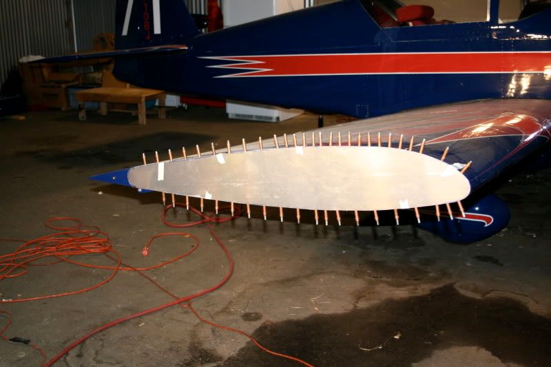

I removed the right 3" streamlined racing wing tip and checked the end of skin alignment with respect to the leading edge using a large square. It is very close to square with the leading edge slightly longer than the trailing edge - at this point I and calling it close enough to perfect that it is not to be messed with.
I installed the right semi-flat tip on the wing and marked where the skin ends on it. The I removed it and applied masking tape as a marker using the edge as the cutoff point. I carefully cut off the the portion of the tip that extended beyond the wing skin using a die grinder and cutoff wheel. Then I reinstalled it on the wing to assure that I had good alignment.
I decided to make brackets for attaching the flat metal plate to this fiberglass flange out of 1/16x1/2x1/2 6061T6 aluminum angle. I cut these using a metal blade in my small Craftsman bandsaw (wear safety glasses). These generally go between the platenuts on the flange and the spacing I used for those platenuts depended on the demands of the curvature of the airfoil. Some of these are very close together and some are widely spaced so the bracket sizes vary widely - some are only wide enough for one rivet and some have to share the platenut mounting rivet (I try to avoid drilling out the existing platenut mounting rivets so as not to affect the tip to wing mounting hole pattern even slightly but I have resorted to it once so far). This part of the job is very critical and vulnerable so I am methodically working through it on bracket at a time. So far I have 16 done and more than 30 to go. It makes a good activity to replace eating and reading when I wake up in the middle of the night.
I plan to do just this one and fly it with the 3" streamlined racing tip on the other wing to verify that it is worth building the other flat metal tip with sharp edges.
The approach looks very good. More later.

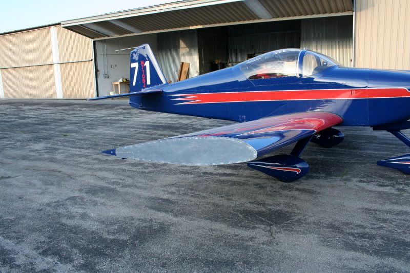

Default Test flew this evening
I test flew this evening with the new flat metal tip on the right wing and the 3" streamlined racing tip on the left wing. The results were inconclusive. I expected a yaw to the left, which I had on the climb out as usual but was it more than usual - well maybe but it was not significantly more if any at all. When I leveled out the ball stayed pretty much centered with no effort from me. I ran a speed test but I was rushed by the coming sundown and my unlighted plane in racing configuration so I did not have max RPM until the second leg and it was not leaned properly until late in the run so the slow 177.9 KTAS is not meaningful. The work time on this "simple wing tip" is much more than I expected. The wing tip fits very well and it is trimmed perfectly flush with the wing skin's outer surface. There is a 2024T3 0.090"x1"x8" stiffiner riveted inside the tail of the tip. There is a balsa wood plug in the end of the aileron. Conclusions: If there is any gain in speed it will probably be small. I will not complete the other one before the race in Plainview, Texas on June 5, 2010. I will build the other tip and carefully test both on the airplane in the future. Below are the two wing tips in today's flight test.
