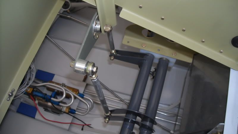

I have a special interest in this story since I've been giving transition training to an amputee friend of mine.
He has a specially modified control system since his left ankle (the prosthesis is on) doesn't 'hinge' at all.
If there's any interest, I can upload pictures.

He lost his left leg above the knee and the carbon fiber prosthesis doesn't 'hinge' at the ankle, so he devised a set of hand-operated brakes between the seats that feed through the passenger cylinders and on to the left side. In this picture you can also see the stirrup on the right pilot pedal.
He welded two arms across the tops of the horizontal rudder pedal tubes that connect each other to a bellcrank he fabricated and allows him to get 'left pedal' by pulling his right/good foot backward, depressing the left pedal automatically...quite ingenious:
Here's a closer look at the bellcrank assembly:
He also moved the throttle control to the left side of the instrument panel so he can taxi by 'twisting' the handbrakes for equal braking or bias them either left or right by simply twisting his right wrist while throttling with the left.
The airplane has both left and right brake systems and the stirrup has been modified for easy removal if the plane's ever sold.

That's a slick bellcrank system, although I'm not entirely sure about the load transfers, etc.. A human being can push a lot more on a pedal than we might think. Not saying it's bad, just saying I haven't done the math on the bolt single shear, etc..
Anyway, the easy way to solve that problem (of interconnecting the pedals for many reasons) is to simply run a cable rom the outer left pedal, forward to a pulley on the fireall (or that main lower longeron) and over the other right outer pedal where you do the same thing. Only takes a little small cable and two small pulleys. Basically you're just tying the two outer pedals together.
Anyway, not criticizing the above install because it looks very nice, just wanted to point this out to others considering it or that maybe wanted to have their pedals interconnected. It's easy, light and not hard to do.
