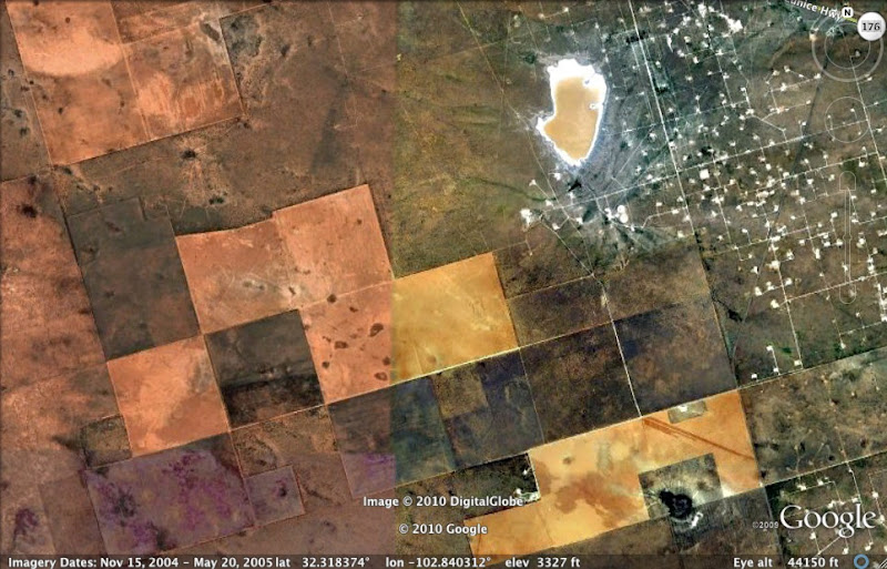

Where I live the lines are very reliably true cardinal directions and I have used them to help swing compasses. I have flown some places in West Texas where they are not. I don't know what they are but it seems like they are off more than if they were magnetic directions. Maybe about 20?. I find it very disorienting.
edit:
I found one of the areas I was thinking about. The photo below is from an area west of Andrews, Texas. The lines are about 15? off in the direction away from magnetic north.

Ah yes, that would be the Exxon Fullerton oil field in the photo. Current supplier of a good chunk of my flying budget!

I have flown some places in West Texas where they are not. I don't know what they are but it seems like they are off more than if they were magnetic directions. Maybe about 20º. I find it very disorienting.
edit:
I found one of the areas I was thinking about. The photo below is from an area west of Andrews, Texas. The lines are about 15º off in the direction away from magnetic north.
That's funny. Maybe the Texas School Board changed the state's geography standards or something.
