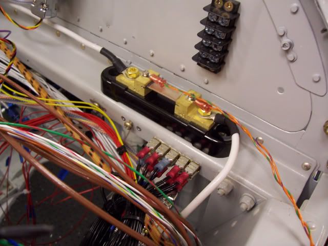

How do other builders insulate a big blob such as the ammeter shunt?

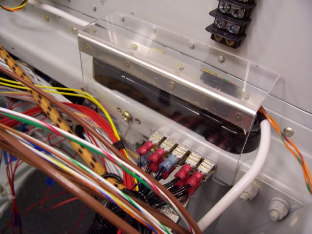

Jim, here's what I did. Like most things, there are likely many ways to skin this particular cat ...
I made a shield of some acrylic that I had lying around and screwed it in place so that nothing can touch it and cause a short.
Hope that helps.

Pretty neat job Don. You've got me thinking!

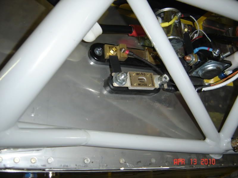

and here's is another way to skin that cat.
I'm using the shunt as indication of alternator load. Therefore the only time mine is hot is with the master shut. It is also under the cowl.
I thought about using a piece of baffle rubber and making a flap, but in the end, I will do nothing. Only time there is any chance of sparking or arcing is during troubleshooting periods, which hopefully will be very few, far between and brain should be engaged.
YMMV, I chose lighter is better
