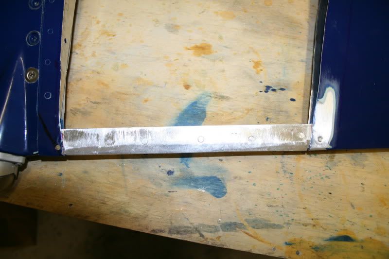

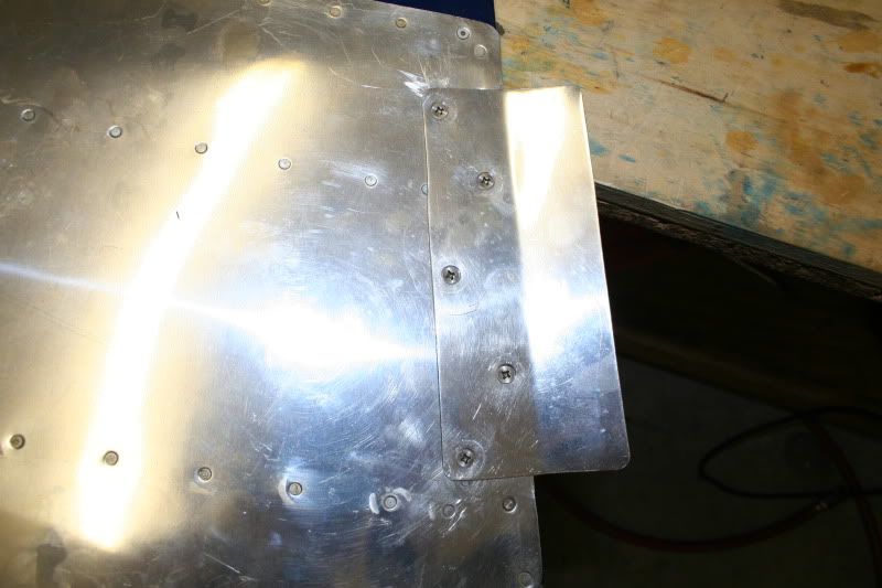

Update: I removed the wedge and installed a ground adjustable tab that is removable with screws. That is the best solution I have found at this point. There is a thread with photos in the forum somewhere.

I flew with the plastic wedge for several years and as I modified the plane the performance changed and the trim could not be adjusted to compensate. As I said earlier I tried the spring system and found it unsatisfactory. I developed a removable ground adjustable 0.032 2024 aluminum rudder tab and it works just fine.
