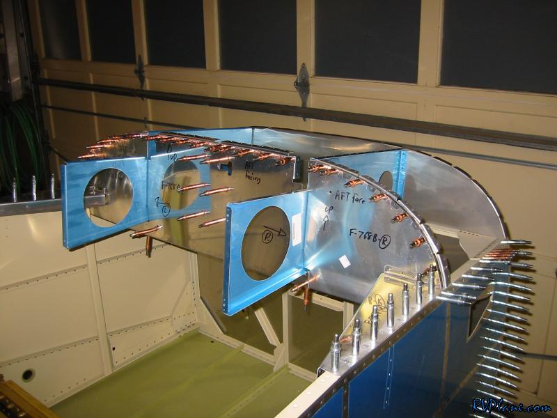

To whom has installed a 10" Skyview..I'd be curious to see what you did with sub panel structure, that connects to the panel. I am assuming that it will be in the way and some cutting and repositioning is involved. How deep is the skyview?

I speaking more to the attached structure to the panel...It will be in the way unless cut and moved...RV7..(stole these pics from Mike Bullock's site)

So attach the blank panel. Build a couple new ribs that attached the panel to the sub-panel. THEN cut off the ribs that are in the way. DO NOT cut off the old ribs until you have new ones positioned.

. . . . on whether it is a slider or not. I have done the layout for mine (slider), and there is no interference with anything. This is with the 10" Skyview centered in front of the pilot (centered on the stick).
