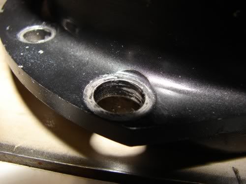

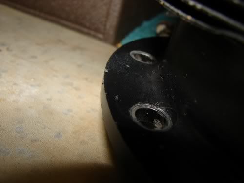

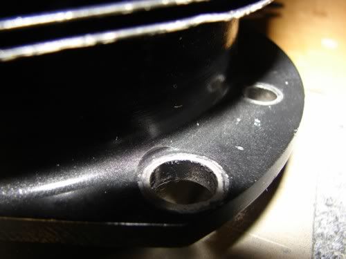

The cylinder that doesn't use the plates, has a spot face machined into the flange where the barrel nut goes. The cylinder that uses the plates, doesn't have this machined area. That is an easy way to tell the cylinders apart.
The crankcase that uses the spot faced cylinders has shorter cylinder mounting studs then the one that uses the plates.

Here are some pix of my number 4 cylinder base deck stud holes. If I understand what you were telling me, these do have the spot face design and the base plates are not needed.
