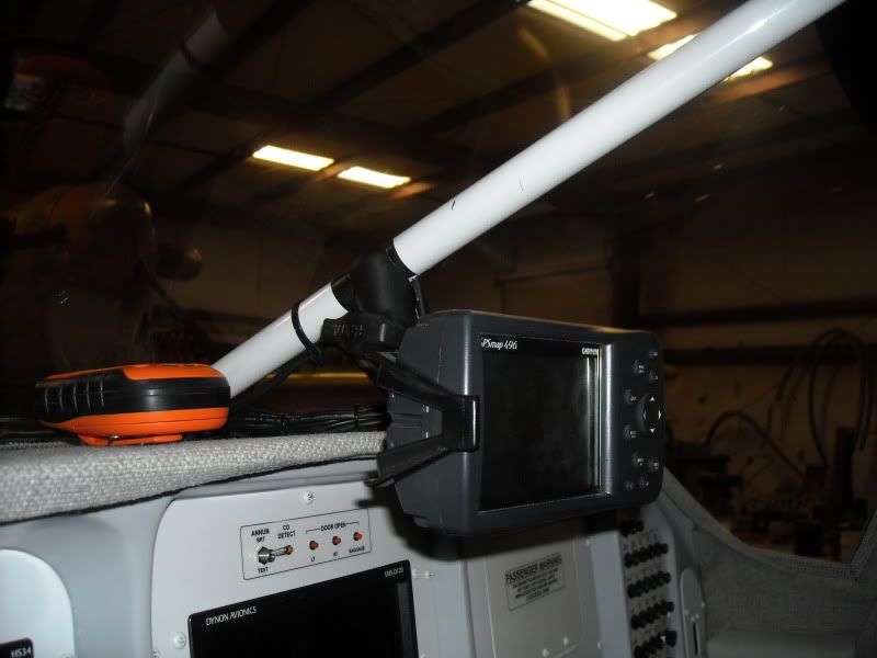

This is a picture of my re-done 496 suction cup mount that I used to have on the left side of my -6A. I kept the mount and for the -10 removed the suction cup and its ball. I then reshaped the leg with a 1" round grinding cylinder to match the roll bar brace contour on my -10:
If you'd like the suction cup ball, you're welcome to it.
