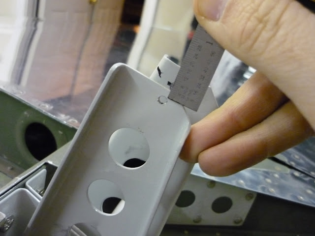

Looks like I will welding shut the hole. It was perfertly perpendicular but I did not notice that one horn was taller than the other, resulting in a close the edge #30 hole...still would have to open this hole to number #12.
Someone told me welding steel makes the steel harder and more difficult to drill into.??....
any advice...

A simpler way of making this repair would be to rivet a doubler of equivalent thickness onto the original horn to give sufficient edge distance. The doubler should cover as much of the original horn as possible for strength.
There is plenty of clearance between the two horns.

I like that idea much better. Would put the doubler on the inside or outside of the horn. Also, should the doubler be steel too?

Yeah, that's 4130 steel.. You'll want to stick with the same stuff, so you have the same strength.
Mis-drilling those horns is a pretty common error. Ask me how I know.

I am not an engineer, but would imagine that any doubler here should be steel. To address the welding and drilling (I had to do the same) I found drilling the hole difficult too. Ended up cutting a larger section of the horn out and weling a new piece in so that the new hole was in vergin material and not the weld. Also, found that it takes a very good drill to drill that stuff anyway. I found that a step drill seemed to work much easier. Once you have a hole it is much easier to drill it larger to the correct size. Happy drilling.

Yes, as Phil said, it should be 4130. Same as the material you are reinforcing.
I personally would put it on the inside (between the horns). You could put it on the outside, but if you do, make it as large as possible radiusing the edges to fit in the channel.

ok...going with Mels plan..and using 4130 steel as doubler. pics to follow

While you are at it make a doubler for the other side and if you make them thick enough you will not need any washers.

I made the same mistake. I was planning on getting it welded, but if I were to some how screw it up again after that I'd be pretty upset with myself.
The doubler sounds like a great idea. Should it be attached with aluminum or steel rivets?

Standard aluminum AD rivets.
