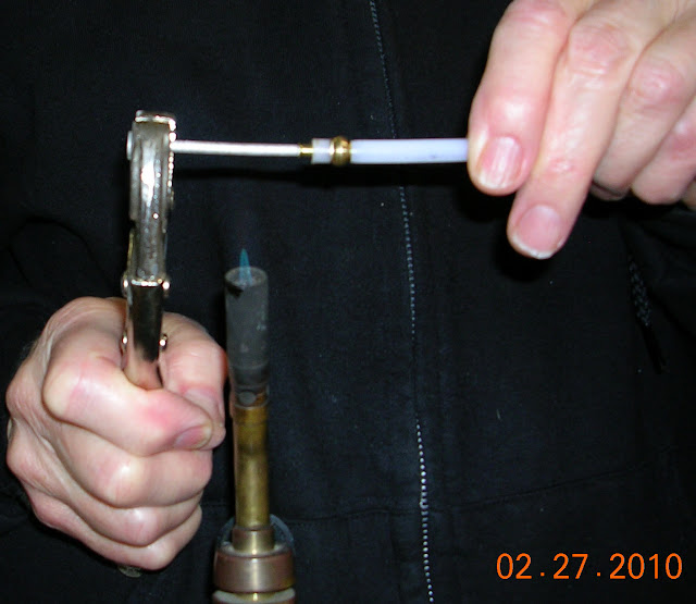

Forcing the brass insert into the nylon brake line tube was difficult for me using the boiling water method. I found an easier way is to push the insert with a hot aluminum nail. I held the nail with vise grips, heated it in the center with a propane torch and pushed. Only a very small flame is needed. As soon as the insert starts going in, move away from the flame. Do not push the insert in too far or else the end of the tube will mushroom. Not much heat is required. Even a lighter or candle might work, but I did not try them.

I thought you put the brass tube in the nylon line before you slid the compression sleeve over the line. Have I been doing this wrong?

I would think either method would work, as long as you don't overheat the nylon.

In an article written by KEN SCOTT in the 2 - 2009 issue of RVator quoted below, is an easier way to insert the brass inserts into plastic brake lines. It is too bad that I did not read that before working on the brake lines.

Did not fancy boilling water so I tried the heat gun approach worked well, just do not overheat.

I must have got some proper sized tubing. I just started them in the tube, then pushed them the rest of the way by putting the brass up against a table edge. Tight, but no boiling water stuff.

I wish Ken had published that defore I did the brakes on 120241. Boiling water just did not work. I worked the tube and insert, helper appkied heat with a heat gun. We found out that there is such a thing as too much heat!
Apply heat slowly, once the tubing starts to "give" it softens quickly!

They mean up against the end of the tube. I found boiling water did not help a bit actually, so adopted the "push it in" tactic. Worked very well for me and my size tubing. It needs some force to push it in, but up against a solid surface it was not too bad.

I always put bead on the tube, (along with the nut) first, but slide it back enough it is not in the area of the inner tub. Then insert the brass insert, and lastly slide the nut and bead toward the end of the tube, final location will be determined when you put the tubing into the fitting, bottom the plastic tube in the fitting, slide the bead, and nut forward, and tighten them down.
I find it makes things easier to put a very slight chamfer on the inside of the bead------if the bead seems to be tight on the plastic tube.
