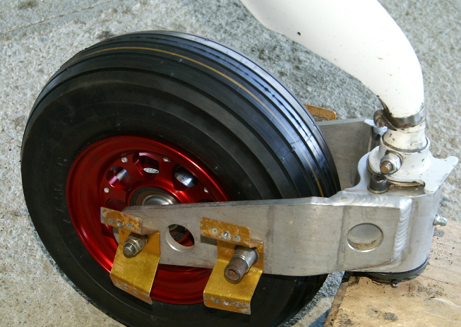

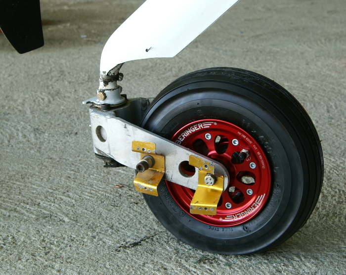

Would love to hear from someone that is using the Beringer nose wheel with some pics of the installation. Are these tires "designed" to run as tubeless?
I got the impression from an e-mail exchange with Remi Berringer over one year ago that Michelin makes a 380x150-5 that works as a tubeless tire. If it has a chlorobutyl or halobutyl inner liner it would hold air as well as their air-stop tubes. I didn't ask him about the 4" tire because I am building a -7.
I am convinced that the wheels themselves would not leak because they are machinings, not porous castings, and the joints are sealed with o-rings.
Since Remi advertises on VAF, maybe he will pick up on these posts.
Larry

Default More info about Beringer wheel
Hello
I got a e-Mail from Rémi Beringer, I hope it is fine to copy it here:
This is a standard size 5” rim with 11x4.00-5 tire. Rim is billet on CNC
with O-rings for sealing and a rigid valve.
Cheng or Lamb 8 ply can be mounted as tubeless but we recommend using the
Desser “Aero Classic” 11x4.00-5.
Tubeless is much safer that is why it is use on all cars, bikes and
commercial aircraft.
With the kit including rim, tire and aluminum axle you save 1.5lbs !
You can get it at AS.
Rémi BERINGER
Regards, Dominik

Default Pictures
So, here are the pictures:
For more information contact beringer direct, I just hand over the pictures and R?mis e-mail.
