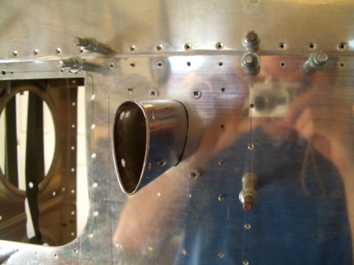

Have an RV6A with the usual tubing type pitot tube. Can I swap to a Dynon aoa/pitot without major modification?

you will need a mast to house the pitot... i used one from safeair1. the mount location laps directly against the spar flange but can be mounted most anywhere along the wing that you have good access to. the 6 is a bit more restricted with fewer access holes so it will be fun routing the pitot and aoa lines to the root but it should not be that bad. for the skyview the adahrs will likely mount behind the baggage bulkhead and so you can just use a tee to feed your current pitot line going to your panel as the line comes into the cabin.

Thanks for the direction. Looked it up at Safeair and looks good.
http://www.safeair1.com/Pmast_1.htm

I also used the Safeair mast. Good price and high quality. IIRC it also comes with a template for cutting out the bottom skin for the mast.

If you remove the fuek tank it will be very easy to route the new pitot lines. You should be able to do it with the tank in place, but it will be much harder to route the lines without chaffing. It also depends on how the current pitot line is routed (per plans or not)

The safeair mast does come with a template. I've seen someone route the new line on top of the Z brackets for the fuel tank (attached with adel clamps); it's easier to install and inspect.

No Z brackets on the RV-6. The per-plans pitot routing in on the forward face of the spar web under the fuel tank held down by a few fabbed clamps.
Even though I don't have an AOA pitot at the moment I ran two pitot lines just in case.

Here is what the pitot mount install looks like on the 6. This is located just outboard of the inspection hole.
