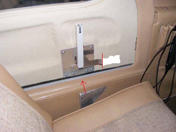

While building our RV-10, we wanted a secondary door latch. We were concerned about possible rescue efforts in case of an accident and complexity and cost.
Here's what we did and so far it works great! A machinist friend, Matt Banks <perfwingsnwheels@yahoo.com> made the parts and made them adjustable to allow for slight variations in doors. (Matt has a beautiful Fairchild 24 with a Jacobs engine.)
The receiver end has three screws that match the pattern of number -8 screws already there in the fuselage . The door handle needed a simple mod with a doubler plate inside the handle to add strength. The end of the secondary latch arm has a machine grip in it.

Hey Vern. Looks like a good solution. Quick question, can you get your latch to engage if the rear door pin is not seated?
Mark
Old 01-26-2010, 08:22 PM
Vern's Avatar
Vern Vern is offline
Location: Peachtree City, Ga
Posts: 1,039
Default Latch with rear pin not in place ???
I do not think the secondary latch will engage if the rear pin is out of place, but I'll have to study it more to say absolutely one way or another.

Looks great Vern. Does the lever always find its way smoothly into the receptacle?
