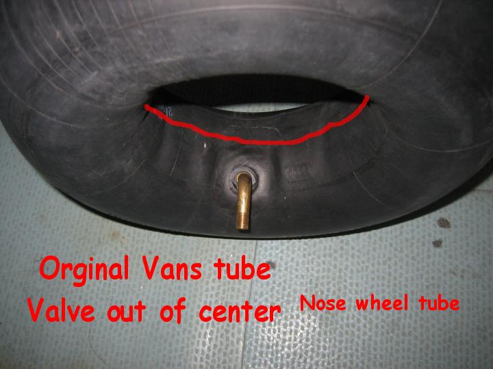

Anybody else had a problem with their Grove nosewheel? I received my 59-2M-RV, and removed the unused (Vans-supplied) tire and tube from the Matco wheel. When I put the tube into the new wheel, the tube stem did not stick out straight, making it difficult to get the inflator onto the stem:
The stem also pushes way in when attempting to add air, so I'm not sure I could even add air without reaching between the wheel halves (bearings not installed) to steady the stem while I push the inflator valve onto the stem. This basically makes this setup unusable. So I tried to install a couple of washers and a nut, which keeps the stem from disappearing like a frightened turtle's head. Unfortunately, the valve stem cap can't be installed with the nut in place.
When the tire is inflated, the stem kicks over to the other side, again making it difficult to install the inflator valve to add some more air without scraping and damaging the paint:
Interestingly, the Grove wheel has the hole for the tube stem in the center of the wheel halves (left photo), while the Matco wheel has the hole off center (right photo):
According to Grove's website, you can "use your existing tire & tube", but I am starting to wonder... Grove says they have never heard of this problem in over 200 nosewheels sold.
Anybody else had this issue? Is the solution to scrap the Vans supplied tube? Does a replacement tube clear up these issues?

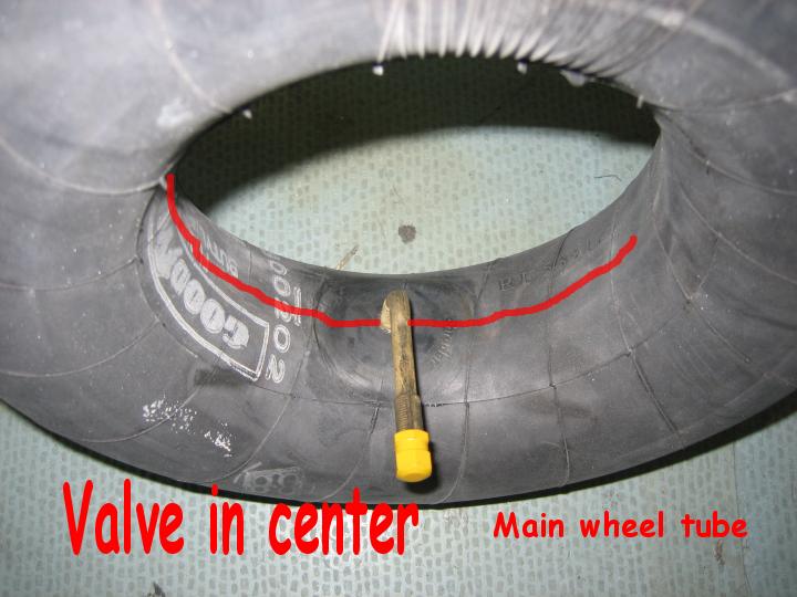

Default Valve is on wrong position!
Hello!
Have a look onto the valve position. On the nose wheel tube (from Vans), the valve stem comes slightly offcenter out of the tube. This is not the case by the main wheel tubes, there the valve stem is absolut in the centerline.
If you look at the wheel halves, the valve-stem cutout is centered by the groove wheel, but not by the original Vans (Matco?) wheel.
I dont know a source where I can get tubes with the valve stem in the center?

Dominic,
I was just looking at my Grove nose wheel and Van's supplied tube and I see what you mean. It seems to me that a tube with the stem centered is required to prevent a side load on the valve stem.
Did you find a tube, or are you just using the Van's tube. Thanks

I ordered my replacement tube last night from Desser, $10.95, P/N TU 11/4.00-5. Here is a photo forwarded to me from Desser showing the stem centered in the tube:
Steve Chlavin at Desser was extremely helpful in answering several questions I had about this issue. If you have any questions, ask for Steve at Desser.

Thanks, I will get one ordered, I know others are using the Van's tube but I don't like the off center stem. With all the issues with the nose wheel, I sure do not want to worry about landing with a flat nose wheel. Thanks for posting the info.
