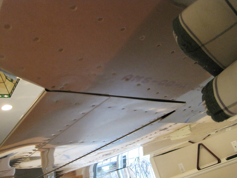

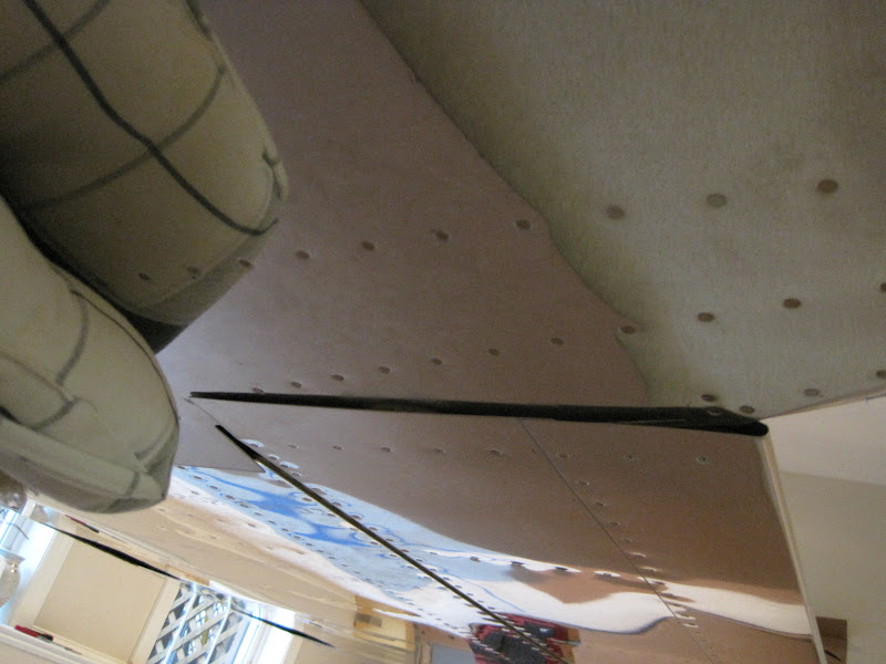

I wondered what other builders are seeing when rigging the flaps. I thought this was a little excessive, but maybe I'm just being too picky.
With the fuselage leveled in both axis, incidence set with Van's 3" Block, ailerons set at neutral, flaps in alignment. I also double checked across both wings at the trailing edge with a digital protractor, all within .1 - .2 degrees.
The right flap droops about 3/16 ".
By comparison, the left flap tucks up pretty nice.

Fly the airplane first. If you have a slightly heavy left wing (not that unusual), raise that right flap to flush.
Having the flaps slightly higher than neutral will help cruise speed a little.

Ken, yours looks almost identical to mine. I felt the same way, but will be taking Mel's advise and take it from there.
