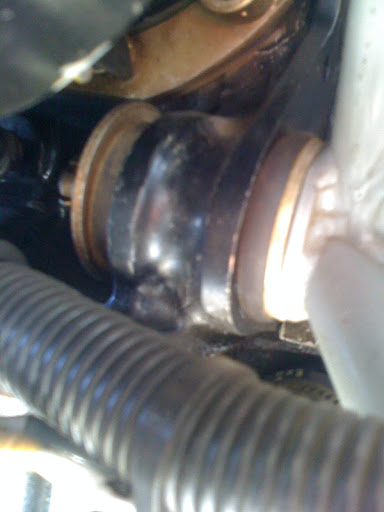

My 0-360 engine is a Conical mount style I have on my 6A... I set up the cowl orginally to be even to the top of the spinner..And was estatic that the engine never did seem to have the typical 'drop' at the front... Then at about 550 hours, I noticed it seemed to drop (or is it drouped).. about 1/8"... Also I was noticing a slight viberation that was beginning to bother me... I just couldn't find any reason for the viberation... Checking the LORD web page 'The Care of LORD Mounts' I decided to change the mounts (J-6230-1) durring my condition inspection... You can see in this picture one of the orginal (top front) mounts and it's obvious distortion:

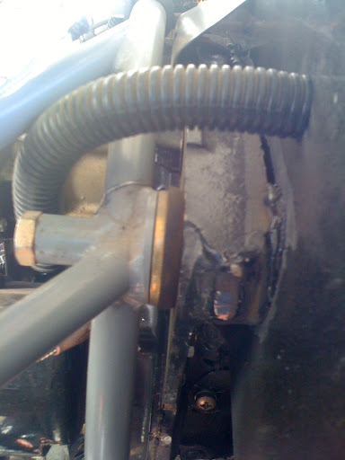

And a picture of the new LORD mount installed on the bird:
The inspection/distortion limits are deplicted on the LORD web page:
http://www.lord.com/Home/ProductsSer...0/Default.aspx
The LORD J-6230-1 mounts are not cheap!.. Also durring install time, they clock at different 90 deg. positions with pins to hold them...
I haven't flown yet (not finished with my condition inspection).. So will report on results..
Sheldon

Yes, the LORD J-6230-1 mounts are the ones to use... I have 550 trouble free (no viberation or sag) with them... Until about the 550 hr mark.. They are expensive... around $90 each... (X 4 of course).. Your conical engine mount should have locating pin holes drilled in the pads.. Those are to allign the LORD mounts with their corresponding locating hole..clocking them at 4 different 90 deg. positions... (The center spacers have off center lobes which are meant to fit into the rubber mounts in one direction)... The locating pin doesn't come with the mounts... You have to provide them.. They are close to 1/8" dia. and are very short...1/4" long...
I talked to an LORD engineer one time and he told me the clocking was to combat viberation and engine torque...
My 6A is of the old 'long cowl' version with a 4" prop extension and I have a Sensench metal prop.. Heavy at the front end..yes.. If your with a 2" extension and light prop, your time on these might be higher...??

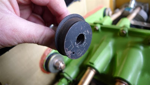

Also here's a picture showing that the rubber was starting to tear off the metal... You can see the hole for the locating pin and that the moung bolt hole is off center...
Sheldon

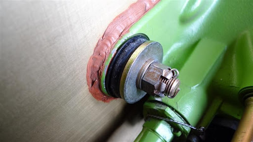

I used the cheap Rubber Conical Mounts that Wag-Aero sales. After 2,000 flying hours, there is no sign of sagging. I purchased new ones to install when I installed new cylinders but left the old ones in.
BTW: (added 1-15-2010) There is NO METAL in the bushings I used and they cost $31.50 for a set of 8.
http://store.wagaero.com/product_inf...oducts_id=3038
