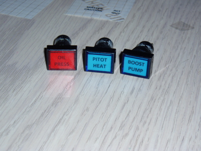

Some people call them “Idiot Lights”, lights that are on under some condition, and off when that condition is not present. There are strong opinions on whether or not they are useful. Annunciator functions can be implemented through the glass panel displays that some are installing, and therefore an annunciator panel is just adding unnecessary complexity.
If forgetting to turn off a fuel boost pump after takeoff, or not remembering to turn on strobe lights before starting the engine makes one an idiot, then count me in. Our RV-7 is going to have an annunciator panel. Exactly what conditions will be monitored is yet to be determined. Two prototypes have been built. Continue reading at our Blog.

Nice DIY blog. I used similar lamps in my HR-II with a dual SkyView.
For those who want a pre-built lamp controller, Makerplane sells 4, 6 and 12 channel controllers. Google IL-4A, IL-6A or IL-12A. These units drive the FMS Microjet annunciators. Occasionally show up on ebay as well.

Actually, I am embarrassed to say that I have still not converted my folder full of chicken-scratched wiring notes into decent-looking schematics. I have all the data - just haven't taken the time to learn a decent graphics program and do the drawings. I mean, who has the time when they have a flying airplane ?!
The wiring is really simple for this though - each LED is powered from the circuit it is sensing with +12 volts. This goes through the LED, followed by a 700 Ohm resistor, and then ties in to all the other LED ground sides before going through a 1K Ohm pot, and then to ground. Any good Aggie should be able to figure that out ! (If you didn't attend Texas A&M, I appologize....)
Almost all of my lights are status indicators, which are wired directly off of the circuit they are showing. For instance, the "Landing Light" LED is just saying that there is voltage on the Landing Light wire downstream of the switch, and the same thing with pitot heat, fuel pump, etc...
The Oil Presure light is driven by a pressure switch through a relay (I had to invert the signal). The EIS is similarly driven through an inverting relay. The power for those relays comes off a circuit breaker on the Essential Bus which is for panel indications.
Sorry I don't have an actual drawing - maybe someday, when it gets low and rainy, and I'm stuck inside....
