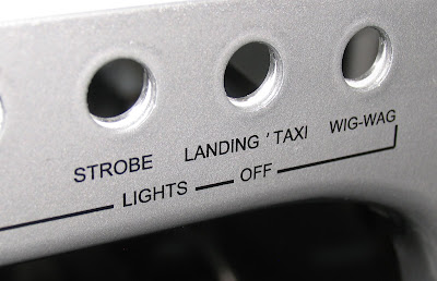

I bought a Decal Pro kit for making dry-transfers. I plan to use it for labeling on my panel.
I was wondering if those who have gone before me have any ideas on how to clear coat the results to improve the resistance to scratches? The dry transfers hold up ok to fingers or general rubbing, but anything with and edge (fingernails) goes right through the material and causes a nasty scratch.
So, is a clear coat the way to go? If so, what brand did you use and was there any special methods for application.
Of course the last question would be, how have your labels held up after using clear coat?

It might be worth taking a look at the type of clearcoat they use on motorcycle helmets. The helment graphics are decals with a clearcoat that is tough as nails...

I used decals and clear coat on the panel labels for my '8.
Not exactly the same though. I made decals used a laser printer on a sheet of lacquer decal paper (think good ole plastic airplane decals). So now you have a lacquer based decal on water soluble paper with the lettering in laser toner.
I sprayed the panel with PPG 2021 clear. This is a standard automotive clear. The results were very good.
Wish I could tell you how the dry transfers will act. The only way to really know is to make a test piece.

I used rustoleum "painter's touch Ultra Cover, with a matte finish. My panel is an enamel the color of the powder coated parts and I did a test of this and one other clear with a satin finish. I thought the rustoleum product looked better. The other seemed to darken the base color a bit. I also used Decal Pro for my labels.
Like most of the clear coats, this one is non-yellowing and UV resistant. I really like how the matte finish turns out, absolutely no reflections from the surface.

We use a standard PPG clearcoat on all the panels. Typically we have a bit of flattner added to it in order to end up with a satin/semi-gloss finish that isn't too shiny. We don't use the decalpro system because it was a royal pain in the rear for the volume that we do. That being said, all of the pro panel shops do use decalse, just a much more industrious type that is printed on a fairly expensive printer. We and our colleagues are able to print white labels directly (or metallics or whatever).
