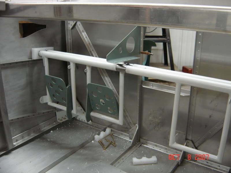

I'am wondering how many built that brace with holes in brace or trimmed brace down after determining they didn't need all the metal and didn't make holes as discribed on lower right on DWG 37A ??? If I leave the F6118 solid does it have any usefulness like maybe a support for the instrunent panel or did it serve as a wire bundle support. Should I trim it (F-6118) ???? I'am building the 9A you know the Grama Grampa plane!!! Ron

yes, I did both trimmed it down and put holes in place. I positioned the pedals for me and also added adjustments holes 1" each direction.
Have a look:

Brian. Looks good. Are you at this point in construction? Do you think theres any benifit to leaving it long?The reason I ask is the block location for your size legs on the the rudder pedal assembly. Is there any set distance for 5'8" guy with a 32" waist and a inseam of 30". I don't have seat cushions yet but looking at Oregon Aero. My back seems most comfortable with seat bottom in the most forward hinge and leaning back to first notch of plate behind seat. It appears that the F6116 closest point is located 6" from the firewall. I would think we have a big FORUM question here that we could carve into stone once and for-all. Just like the shoe store employee with that foot sizer thingee! A CHART! we could ask your inseam, how tall are you, what seat bottom hinge do you like, how far in inches is your seat back from the cross beam behind it. How thick is your cushion back and seat bottom. With this info we could find out the location of the rudder padel bearing block from the firewall and where to drill the holes in the F-719 FWD Skin Stiffner for that bearing block. So Brian we should ask all RV 7 & 9 builders their hole distances from the firewall. Ron

for placement, I built up several inches of cushioning to try to figure out what felt good. I'm a large guy 6' 230# so have the seat in the last hinge for stick clearance. Then I set the pedals for comfort. I felt this was a good location for myself AND had adjustment range for folks longer or shorter if need be.
I'll try to take a measurement tomorrow. One thing if you leave it long now, you can do whatever later. cut it short and you are out of options.

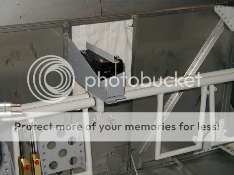

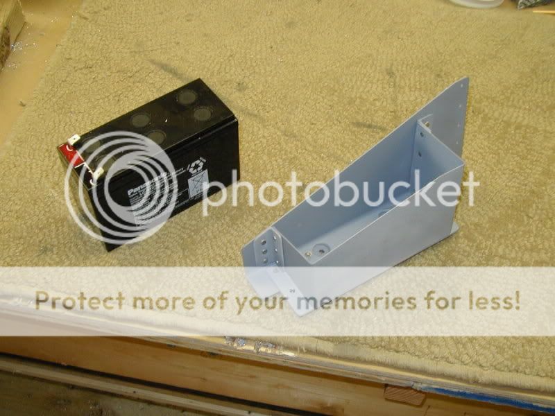

Ron, you'll probably find other uses for this brace as you go along. I found it made the perfect mount for a second battery. I should have cut lightning holes like you did! It also serves as a convenient place to support brake lines and wire bundles later on, as you mentioned.

Pat, What a great idea! I like that for mine. I think tomorrow I'll drive up to vans and buy another bracket (F6118) and put it on the other side of access hole of firewall. Its 25 minutes to Vans. Many trips made there as a newbee to the QB 9A, Cool huh Ron
