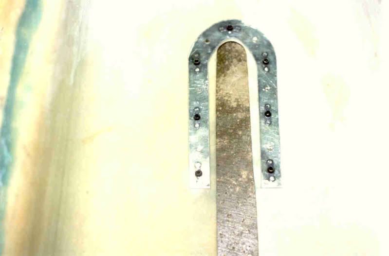

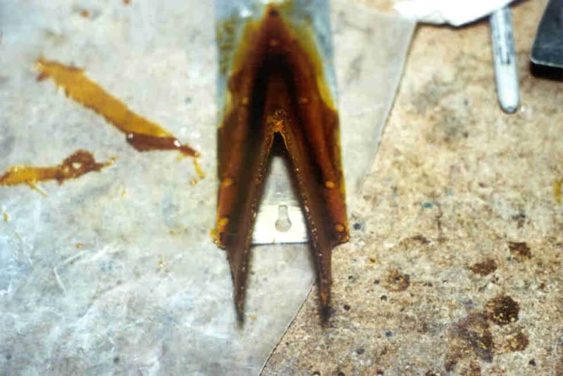

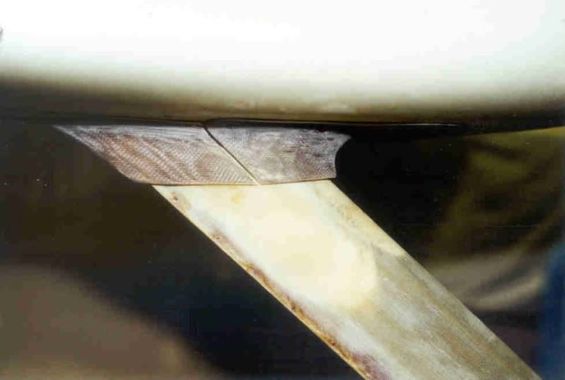

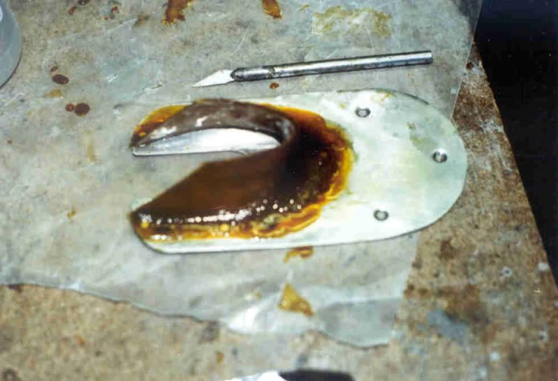

Default My approach
I made 0.032 base plates then built up a mold with modeling clay in place on the airplane. After the first ply cured I cut it in two at an angle in line with the nose gear strut. Two more layers were added. I made a "U" shaped backing plate to support the platenuts for mounting the forward half of the fairing and I used the aft cowl center support to mount the platenuts for the rear half of the fairing. The foward installation uses 7 screws to sandwich the fairing to the cowl. The holes in the base plate are dimpled and no washers are required. The rear fairing is supported by three centerline screws. The first one is screwed in to a soft snug fit with a keyholed mounting point in the base plate and the two rear are normal installation screws through normal holes. All hardware is #8. Photos later.

Backing plate
Forward Fairing
Rear Fairing
Installed Fairing

Bob,
It looks like you left a bit of clearance at the front and the back, so that the leg can move, but I see a lot of planes that have intersection fairings that fit real thight around the leg fairing, not allowing any movement??

Old 12-02-2009, 12:45 AM
Posts: 5,685
Default Not a big Problem
I did not purposely leave a gap to allow for gear leg flexing but I didn't try to jam it hard against leg fairing either. Because of the short distance from the end of the leg mount cylinder and the bottom of the cowl there shouldn't be a lot of relative movement. Paint wear will happen but that's about all.
