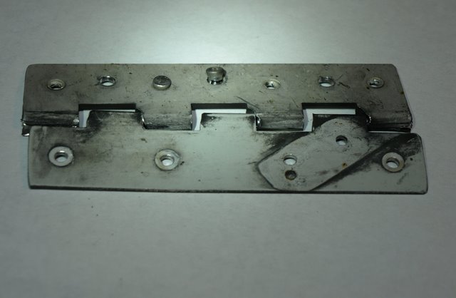

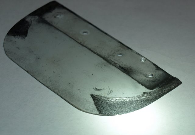

I began the annual conditional inspection yesterday knowing that I would need to replace the hinge on the alternate air door, as it has been getting pretty sloppy the last few years. Here are some pictures of the parts.
Big picture, so to speak:

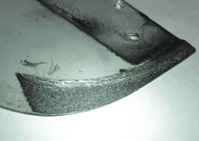

Note below how thin the edge had worn, over 3/4's the .032" thickness is gone:
The hinge is also quite worn laterally:

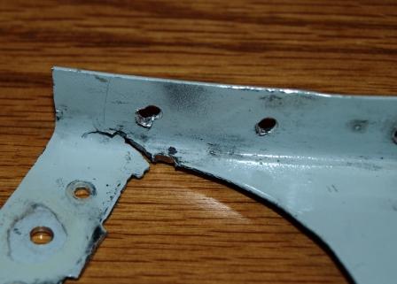

Here is a picture of the airbox top showing a crack, which has been opened up during removal:

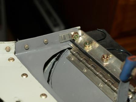

This shows the small angle I reinforced the top front with:

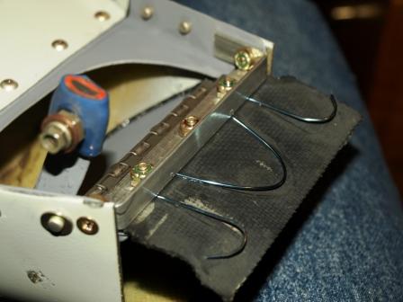

This shows the small silicone rubber bead to prevent future chafing:
