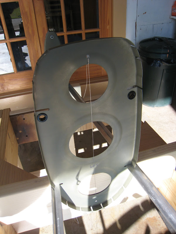

2) Make centerlines on bulkheads. When jigging the fuselage bulkheads of a slow-build, you can run a taught piece of thin safety wire between tooling holes on the top and bottom of the bulkhead. Stretch it tight, and you have a perfect centerline. Line this up on the jig centerline, and check it against level with a plumb bob, and your bulkhead is straight, centered, and true!
