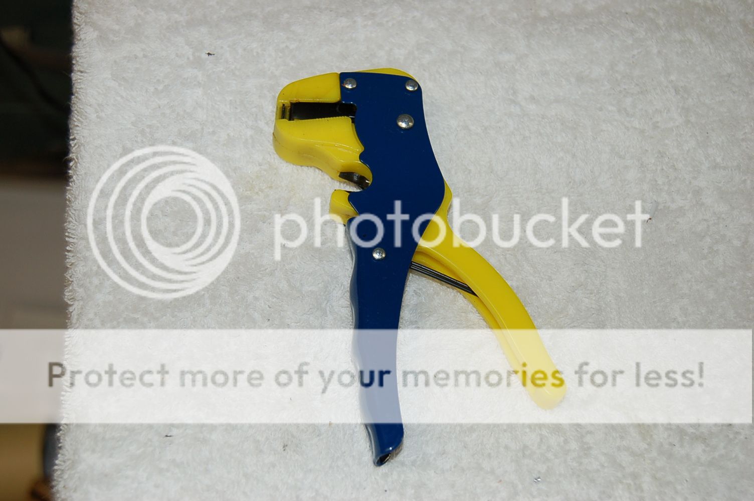

The multi-conductor shielded cable I bought from B&C and Aircraft Spruce appears to be #24 AWG. Is there a secret to stripping wire that small. None of the cheap-to-expensive tools I have goes that small, only to 20 (I have one that says #22, but I'm pretty sure that's a dang lie!).
And, of course, I don't want to just take a pen knife or something to strip the wire and risk damaging a strand.

Bob do not use this junk it only damages strands and elongates/stresses the insulation.

Bob,
The electrical system is good reason to buy an enterily new set of tools.
I have one of these and it works great!
