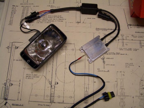

I am installing two LE lights (one per wing) in my RV-6. I started with Duckwork's basic 55watt kits and purchased a slim-ballast HID kit on-line.
I chose this particular HID kit since the ballast has mounting points cast into the case. There are quite a few kit out there that have no mounting and just come with double-sided tape - no thanks.
I ordered the kit with H3c (H3 compact) bulbs with 4600K color temp. I am using the reflector from the duckworks kit so it is important that the correct bulb be used to match the design of the reflector focal length.
Here you can see the setup being bench tested with the HID bulb installed in the reflector that came with the Duckworks kit.
