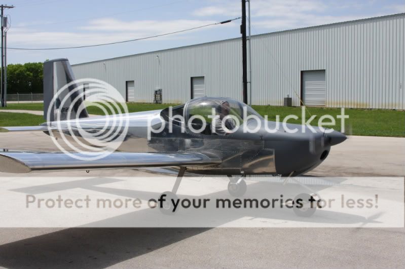

Originally Posted by kell311496 View Post
First flight this morning - flies beautifully. Thanks to all of you who contribute to this forum - your help to us first-time builders is invaluable !
http://s900.photobucket.com/albums/a...nt=move019.jpg
Congrats! Your plane is beautiful. You'll love flying it.

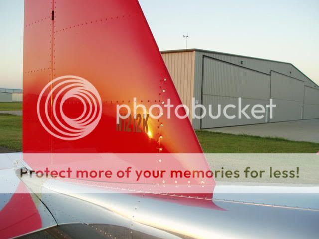

Default First Flight N7771
First flight for the N7771. 1/25/2010. Test pilot Mike McMains reports all normal and a pleasure to fly. high quality picture
