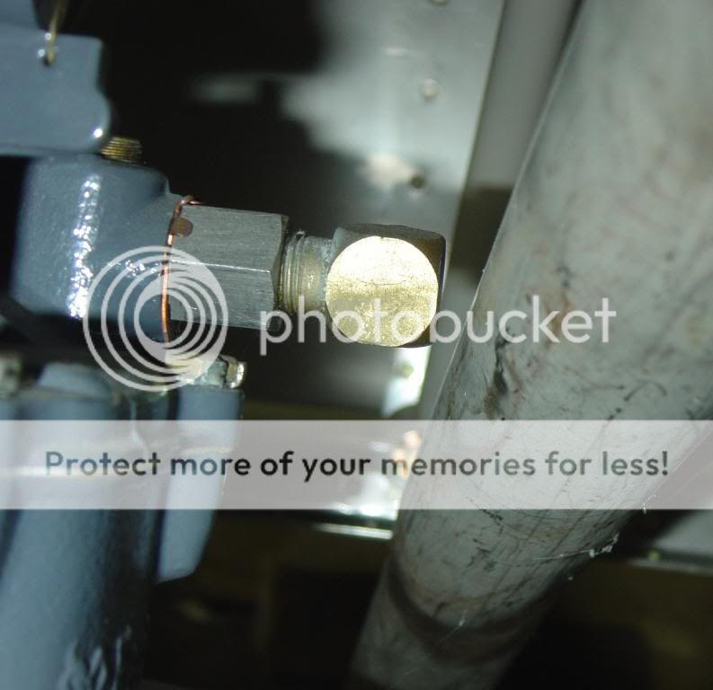

Sorry I am hijacking your thread here but you have highlighted a similar concern I have about the proximity of a fuel line/carb connector to the exhaust pipe on my RV6.
I have an 0-360 with a 4 into 2 exhaust system (no flexible joints) and as the photo shows, the carb fuel hose connecter is only about 1/4" from the exhaust pipe. Unlike Kelly's situation, the hose itself is directed well clear of the exhaust system, it is the connector that is worying me. I am hoping the collective wisdom of the forum can offer some insight, is this OK or should I be looking for some sort of 'low profile' connector?
http://i456.photobucket.com/albums/q...c/DSC03055.jpg
I doubt there is room for a heat shield in the current configuration.
Thanks in advance, and again apologies for moving in on your thread Kelly.
