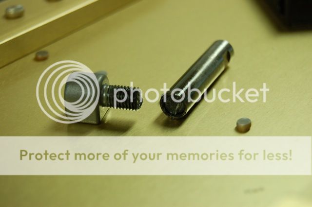

Like Bill said squeezer is a personal choice. Nice to have but I never had one. When I started the budget was tight and I was using Avery hand squeezer everywhere so aggressively that replaced that bolt THREE times When I had money for fancy pneumatics all major riveting was done Your choice.
