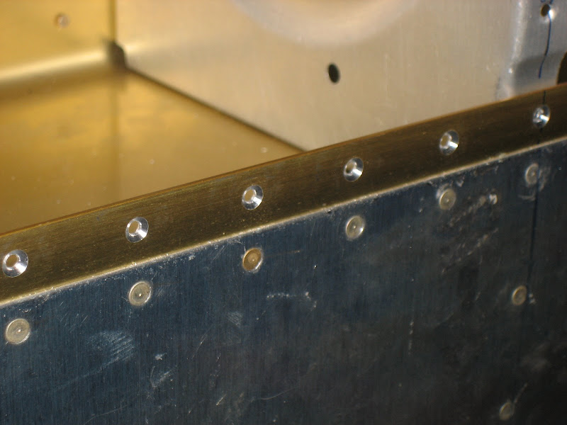

One of the great joys of teaching is to see a student come up with a clever idea, all on their own!

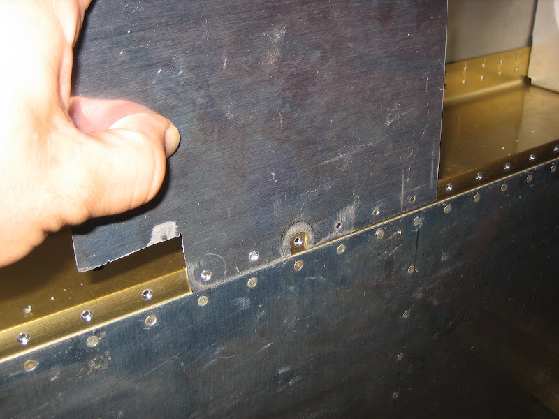

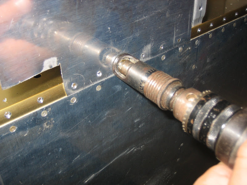

The other day, Louise was busy dimpling and countersinking the lower outboard wing skins on the -3B project, and I was piddling around with other little tasks in the shop. Occasionally, she?d ask a question on technique, and we?d walk through the thought process towards an answer. When it came to where the skin overlapped the spar, I pointed out that the spar was too thick to dimple, so she?d have to countersink it ? but then I asked her to consider how she was going to use a standard countersink cage to do that with the ?step? from the already-installed skin so close to her line of rivets. I showed her a picture of a modified countersink cage intended for the job, pointing out that we didn?t have one, and that she should be able to get by without it - then walked away to let her ponder the problem.
Shortly, I heard the sound of the countersink drill doing its repetitive task, so I wandered over to see what she had come up with. Sure enough, she had built herself a tool! A scrap of wing skin with a ?U?-shaped cut-out gave the countersink cage a flat surface on which to rest!
I?m sure she isn?t the first one to figure out this little trick, but I don?t remember seeing it documented anywhere here before, so here it is for the archives!
I love having a student who can take the basic techniques and extend them to solve problems on their own!
