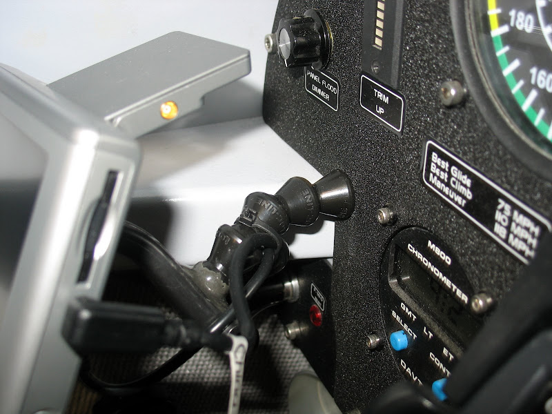

Anybody have any ideas for how one could fabricate a "gooseneck" type extension arm for Stein's LED map light? Right now I have the maplight screwed into the base that Stein provides, but it would be really nice if I could extend this with a gooseneck for easier pointing.

Hi Phil,
Looks like the -9A is coming along great!
I have used a product call Loc-line with great success.
I just use JB-weld to make the attachments. Loc-line is flexible, yet stays where you put it.

Default Loc-Line is Hollow
Bob,
the Loc-Line is hollow and can be built up in any length. I ordered one of their demo kits and have made a few projects out of it. Pretty cool stuff, lightweight, and comes in colors, too.

Default Attaching loc-line to panel?
Pete, How did you attach the loc-line to your panel? I see you used JB weld on the GPS end, but not obvious to me how you did the panel end.
Also, did you find that the little loc-line pliers is necessary for building up a line, or is it easy enough to do by hand?
