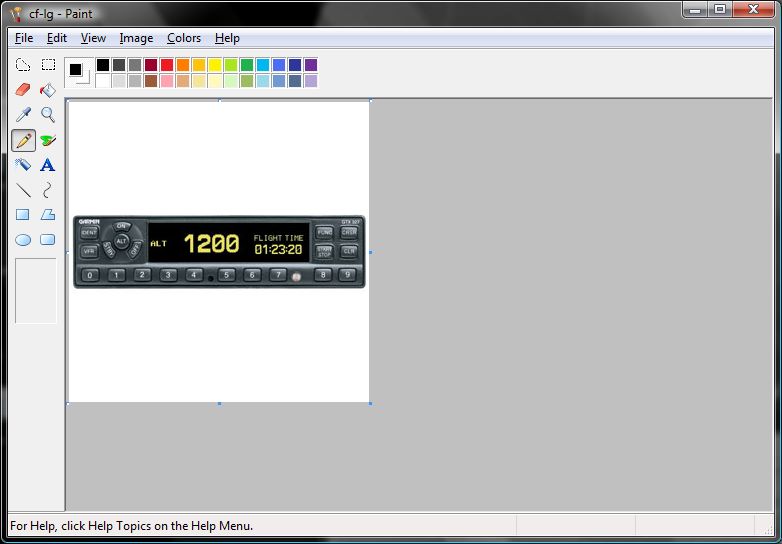

First of all, find a picture of the radio you are interested in. For all of Garmin's radios this can be done on their website. Find the highest resolution image you can find on the site (doesn't need to be perfect), right-click on the image, choose "save as" (or whatever your browser says) and save the image locally.
Step 2:
Open the image in MS paint on your PC.
You will notice in this image the additional whitespace that is around the radio bezel. We will need to remove the whitespace around the image so we can size the image properly.

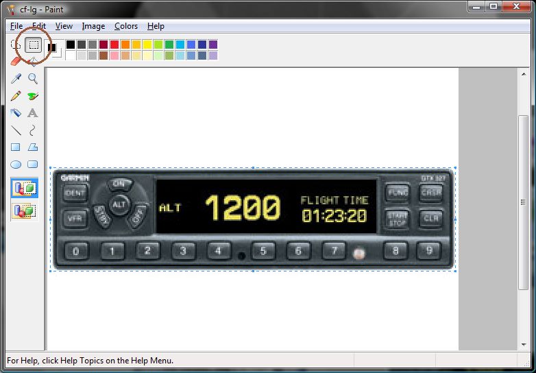

Step 3:
Click on view->zoom->200% to zoom in. Then click the square selection tool and carefully outline the image and removing any whitespace. Then click "edit->copy". This will copy your selection as an image onto the clipboard.

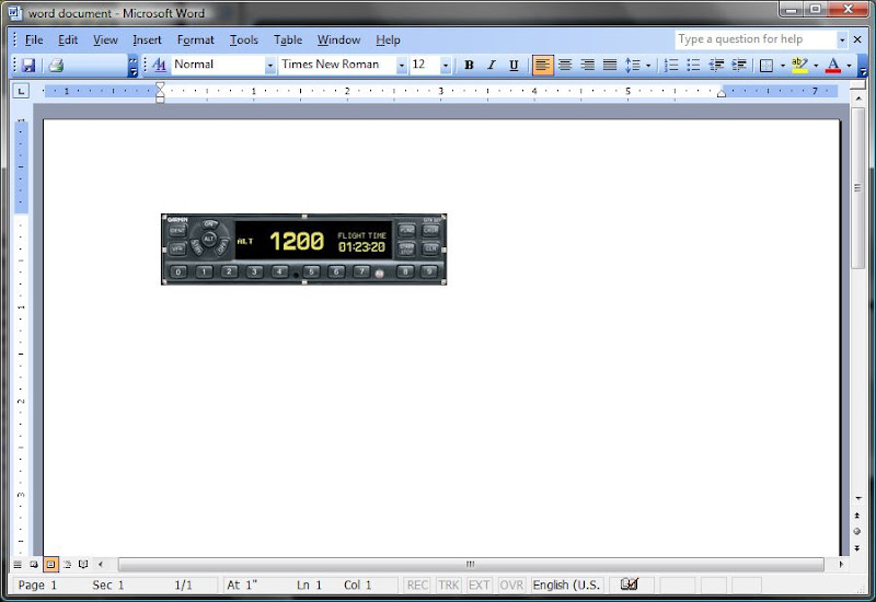

Open MS word (or your favorite word processor) and click edit->paste. This will past the image into the document.
Step 5:

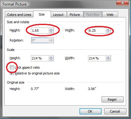

Double click on the image in your new word document and you will see a popup window. On the window, select the "Size" tab. Be sure to uncheck the "Lock Aspect Ratio" checkbox FIRST. Then enter the bezel size as provided by the manufacturer. With Garmin radios, this is available from their specifications document which you can find on their website for each product. Here is the GTX 327 document that I used for this example.
Step 6:
Click "OK" and you should now see that the image has been sized appropriately. You can combine more than one image on each page to conserve paper.
