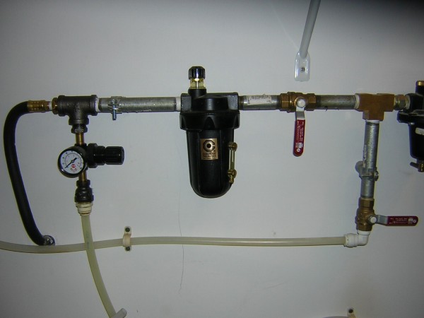

Thomas, this plastic stuff is probably easier to install now, before the walls are closed in because you won't have to clip it into place. Just drill the studs and pop it out where you want it.
It is cheap and good for 90 psi... and it hasn't blown on me yet.

BE VERY careful using PVC for airlines. I had a fitting come apart and sent a 2 ft. piece of 3/4 PVC 50 ft. across my shop. When it hit the wall it shattered into a million pieces. It was an absolute missle. I now use only black pipe for air. The PVC sure is easier but in 30 years I have never had a black pipe air line come apart.
One other point: I think it is also against OSHA Regs to use galvanized pipe for air lines. Supposedly the galvanize can flake off the inside walls and become tiny projectiles that could be imbedded in what ever body part was in the air stream. That's why I have always used black pipe. I bought a used air dryer on E-bay that came out of a dentist's office and boy does that work great. I have totally dry air now.

We recently plumed my son's metal fab shop for air. Used the green stuff. Thought it was a type of PVC but found out that it is ABS. Also found out that OSHA requires it because if you hit PVC under pressure it shatters (like one of the prior posts).
I've heard a lot of people using PVC without problems and OSHA is probably not a problem in your private shop. Also, the green stuff is a lot more expensive than PVC.
Whatever you use be sure to put a low spot in it and a drain.

I know the BIG shop that employ me is using some gray plastic stuff, I assume since it is well over 30 years old it can't be any better than the PVC. I didn't know that about PVC however, and when I get a chance I will change it. I'm not too worried about my glue joints for the moment however, since I pressured it up 15 minutes after it was glued with no problems.

I just used threaded copper tubing to make my setup. And ditto what everyone's saying about PVC....totally not what you want on the air line.

Yah, sooo anyways... for the record...
What I have is not PVC.
Thomas. You may want to give it a try.
